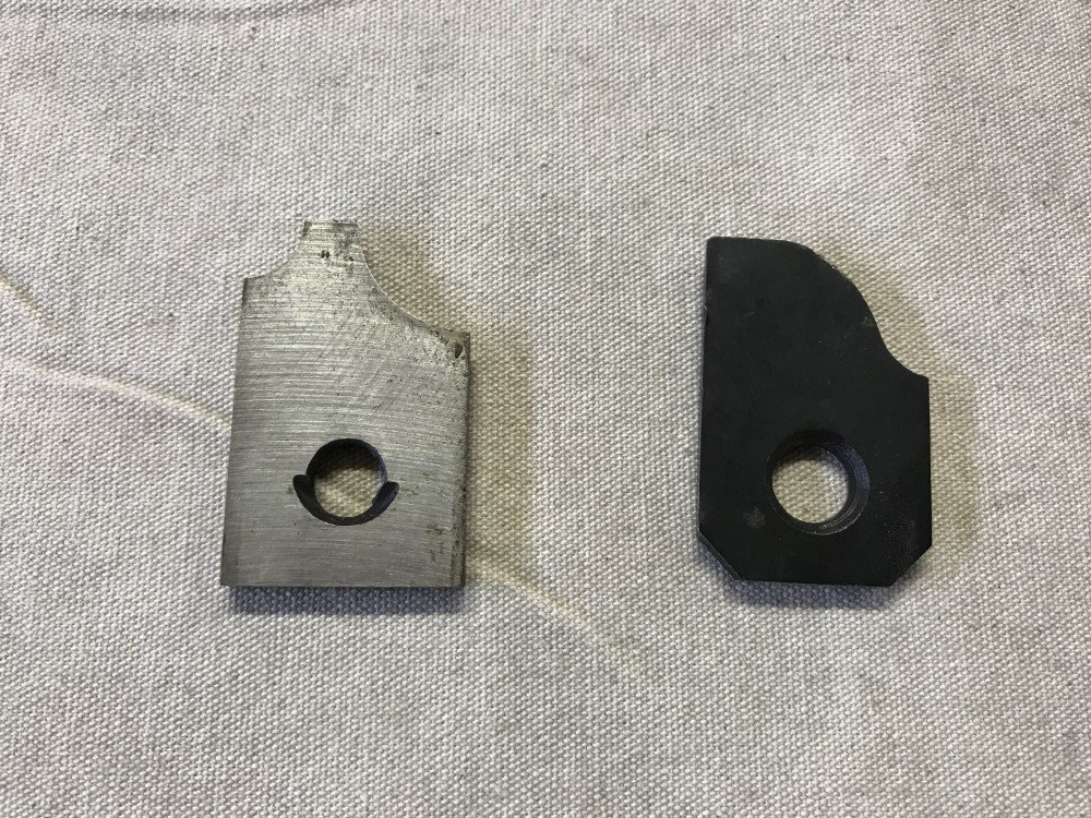

Besides having these knives, I also have knives from other brands. Having other brands may be how you are getting more knives. Besides being made for the Shopsmith Tools like the Mark 5 with the Magna name, Magna Engineering Corporation made their Molder Head and Knives under the PowrKraft name for Montgomery Ward.
The picture below shows two versions of the Molding Knives. The one on the left is the earliest version and the later one on the right has the black protective coating. Notice the difference in the hole the set screw goes into to hold the knives in the Molder Head.
_
Molder Knives.jpg (280.69 KiB) Viewed 67347 times

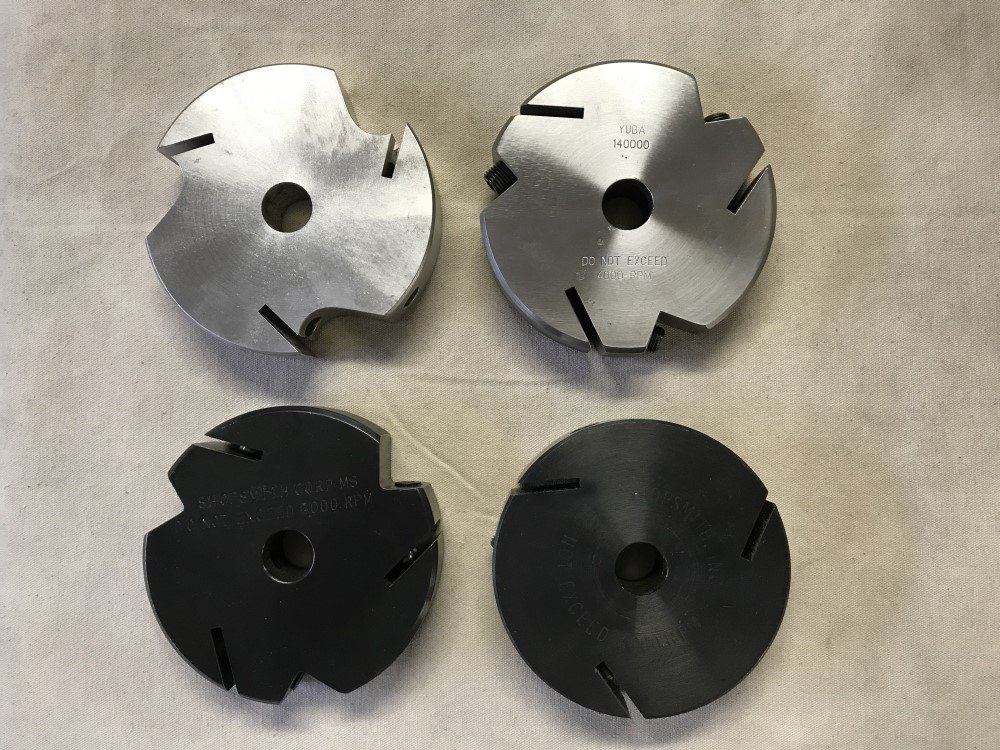

Prior to Shopsmith discontinuing selling the Molder Knives they changed the Molder Head to fit Knives from other suppliers. In all there have been five Molder Heads made for the Shopsmith tools. The first four are shown below. The top two being, from left to right the first and second versions. On the bottom left is the third version and the same as the second version but with the black protective coating that began in 1964.
_
Molder Heads.jpg (174.46 KiB) Viewed 67347 times

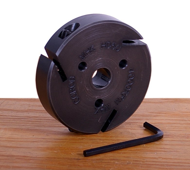

Below is the most recent Molder Head. This one is different as it was the first one that required an Arbor (505506 Molder/Dado Arbor) to use. The earlier four Molder Heads could be attached directly to the Shopsmith Spindle.
_
556213 Molder Head new.jpg (62.98 KiB) Viewed 67347 times

JPG is correct. The last Knives were a different thickness and therefor the Molder Head was different. The 2 Knife versions I show in the picture above are able to fit in all four of the Molder Heads (top 2 part numbers 12 375 pre 1964 and bottom 2 part numbers 505533 1964 and later) in the group picture. The last Molder Head (part number 556213) was made for the Knives Shopsmith was buying and I believe howard is correct in that they are Corob Cutters. That last Molder Head and those Knives are ones I do not have. When that change came a few years ago I already had all four of the previous Molder Heads (those in the picture are mine) and most if not all of the different Knife patterns.
