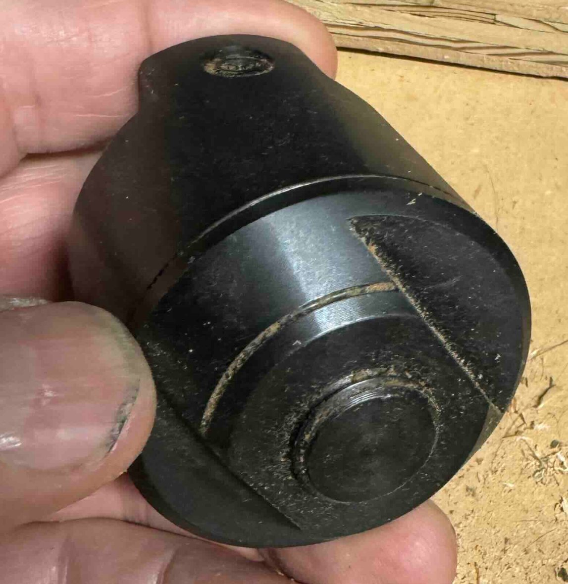

I found this adapter in the parts I acquired when I purchased a used ShopSmith Mark V 510.
Does anyone know what this tool is for?
It clearly fits on the 5/8 spindle shaft but what is it for?
TIA
- UnknownTool.jpg (174.95 KiB) Viewed 156004 times

5/8" saw arbor.

Cheechako,

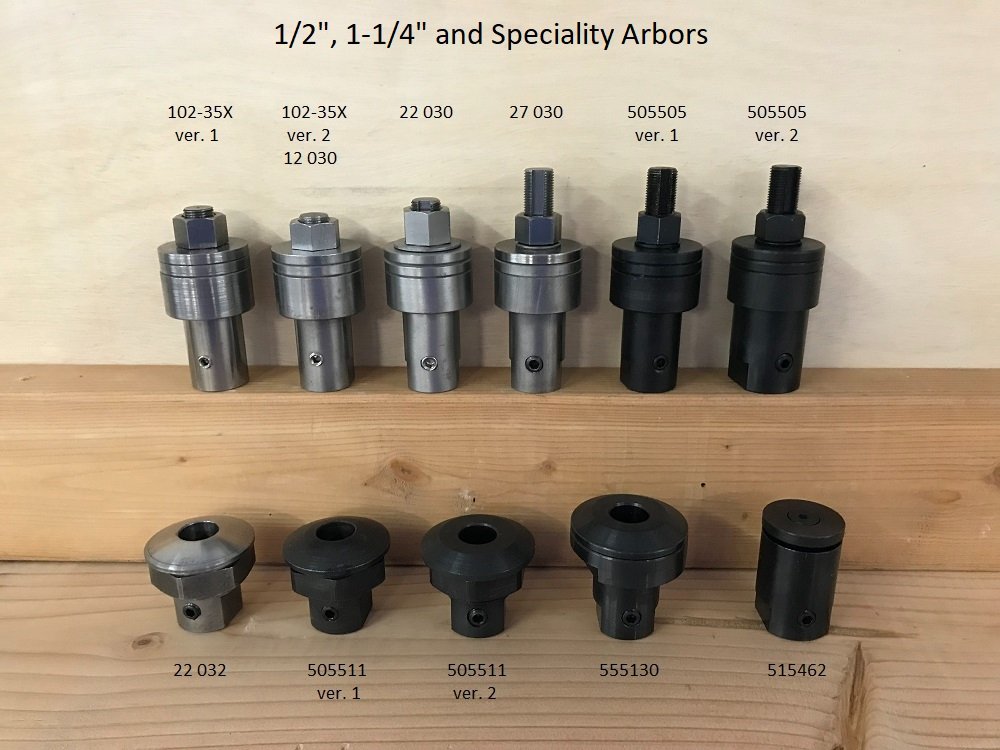

As JPG said it a 5/8" Saw Blade Arbor. It allows you to use Saw Blades from other manufacturers that have a 5/8" Arbor hole as opposed to the 1-1/4" Arbor Shopsmith Saw Blades. It is one of many Arbors that have been available over the years to use on the Shopsmith tools. The pictures below show the different Arbors and yours is the one on the lower right in the first picture.
_
- Arbors page 1 - labeled.jpg (150.85 KiB) Viewed 155777 times
- Arbors page 2 - labeled.jpg (108.45 KiB) Viewed 155777 times
There are other Spindles (Shaping) and Chucks (Router, Drill) available for the Shopsmith tools.

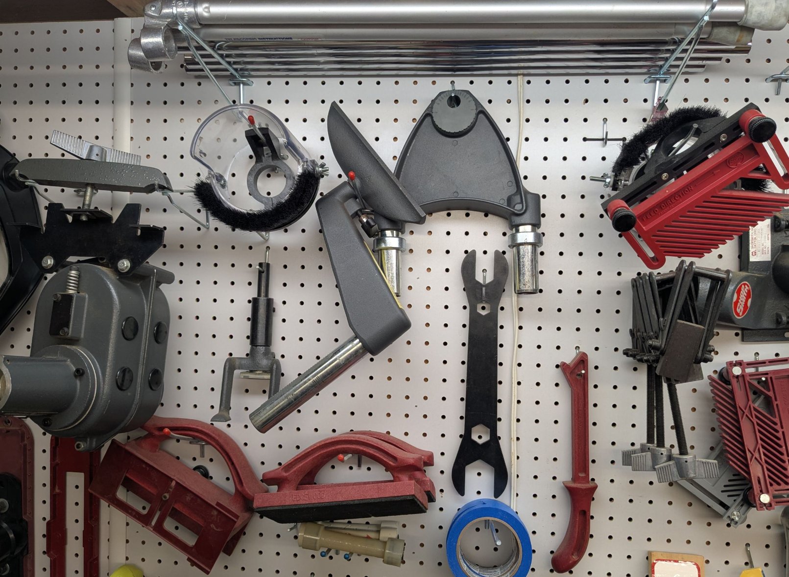

Thanks. I had no idea this was a saw arbor. That also explains why there is a this big honkin' wrench in the parts box.
Appreciate the guidance. Thanks again.
- HonkingWrench.jpg (100.04 KiB) Viewed 152907 times

THAT is definitely NOT SS oem.
Oh yes it is! see below

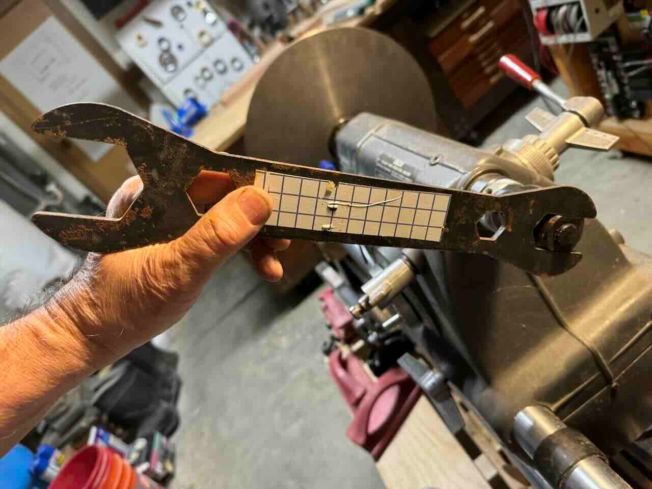

JPG wrote: Tue May 13, 2025 1:11 pm
No? I bought my circa 2005 520 used, but one of those was included with the accessories.
- Capture.JPG (351.28 KiB) Viewed 151714 times

If you search for "Arbor Wrench" on the improved SS website you get 59 matching products. But they do include that one on the second page:
https://www.shopsmith.com/product-page/universal-wrench

Yeah, that is exactly what my SS arbor wrenches look like. One I got new from SS when I bought my 510 and I bought a 2nd one a few years ago. I prefer wrangling with saw arbors off the Mark V so a 2nd wrench is A LOT easier for me. Both look identical even though it had been a couple decades since I bought my 510.

Ahhh the foibles of buying stuff too long ago! Obviously I stand corrected!

JPG,
No worries. Do you have a different looking arbor wrench that you got from SS? Just curious if the origin of these changed over time.
