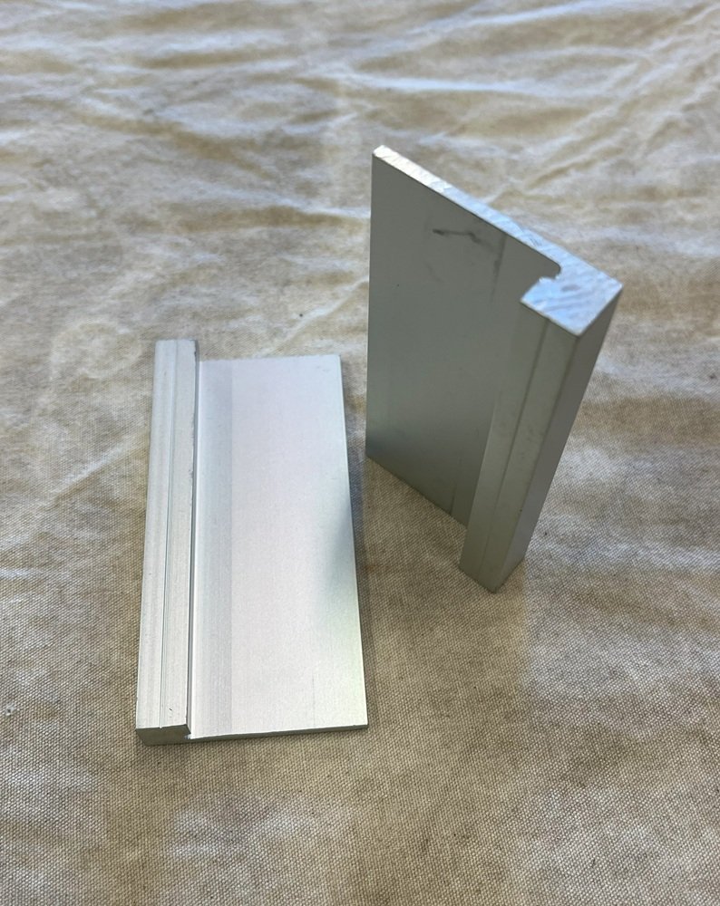

A couple of things to remember: the 510 table will not fit in the 500 carriage, so you will need the 510 carriage as well. Also, there is an aluminum gauge for setting the 520 rails, which is handy to have.

The prices I see for the tables are a bit higher for the 520 then the 510/505 on the used market and new parts for that matter. If you are wanting the 520 Pro Fence, I would suggest looking for that instead of buying the 510 and upgrading, it. That would likely be less expensive in the long run. Since you already have the Carriage and Saw Guards for the 510/505, 520 etc. models you would want the Main Table Assembly (including trunnion and posts), the Extension Table (it uses the same lags as the 500), The 2 Floating Tables (they are the same as the Extension Table without the mounting bolts for the legs), the 4 Connector Tubes and the 2 Adjustable Support Legs. Add to that the longer Saw Blade Arbors both 5/8" and 1-1/4" if desired plus the longer Hub for the 12" Steel Sanding Disk. 12" Sanding Disks with the shorter Hub or aluminum ones can still be used but not with the Lower Saw Blade Guard for dust collection.
There are two versions of the 520 Front Fence Rails. The original one and when the Mark 7 was introduced it added a magnetic strip to the hold ruler scales. Either version will work for you and I have both types. I really don't use the scales myself.
As RonKlein said you will want the Alignment Gauge for setting the 520 Fence Rails. Sorry I don't currently have a picture of it.
EDIT: Here is a picture of the Pro Fence Rail Setting Gauges.
_ .

Quick sketch of the gauge(s -- there are two)chapmanruss wrote: Sun Jun 22, 2025 12:42 pm
It appears to be milled from 1/8" thick aluminum angle. The 3-3/4" length is unimportant -- longer would be better.
