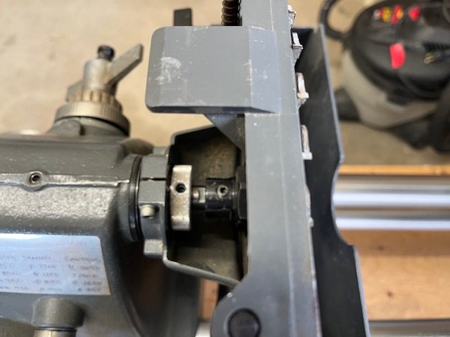

I bought the afore mentioned SS and was very excited. Had no idea this existed. I got it home and saw that it didn't have the upper and lower saw guards. So I immediately got on the web and started looking. Low and behold Ebay had a host of SS parts! I ordered the guards and added the lower carriage. That's when I found out all parts are not interchangeable. When I installed the lower guard (according to the manual) I found that the saw blade would hit the inside of the guard before it was far enough on to fully engage the flat spot on the quill. And the lower carriage holes for the table are wider than the parts I have. I would like to upgrade to the 520 table and extentions for the better fence but the price is prohibitive as I'm in Canada and the exchange rate is 40%!! I don't know if I can trust the ebay sellers to tell (or even know)if their parts will fit me 500 or not.

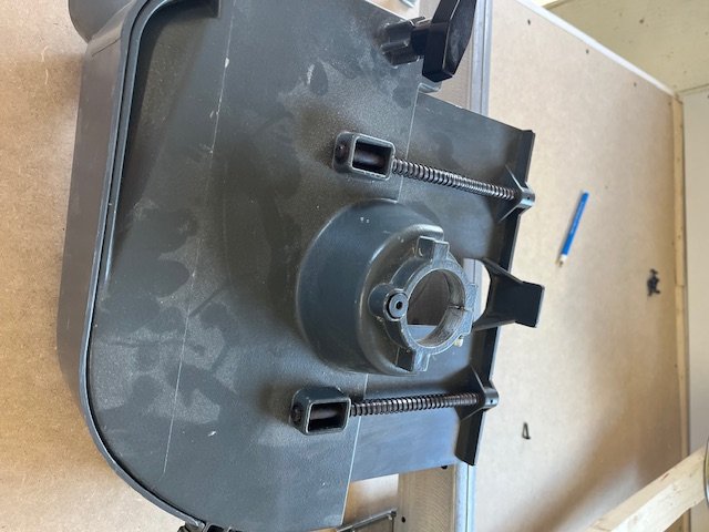

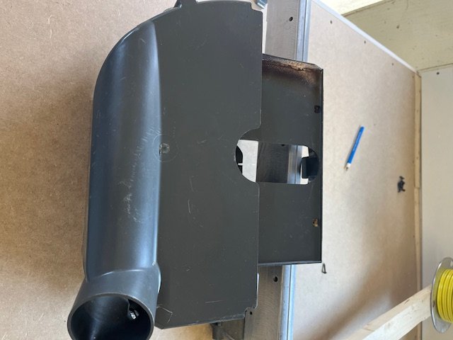

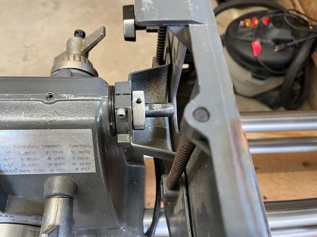

IMG_0093.jpg[/attachment This is as far as the guard goes on the quill. [attachment=5]IMG_0094.jpg
The second pic shows where the arbor sits . Notice that the blade is touching the guard and the arbor is NOT far enough on the quill.
Pic 6 shows that the arbor is barely on the quill
pic 7 shows the blade touching the guard.

franknsled wrote: Sun Jun 08, 2025 10:22 pm Could I just go with the 555608 arbor? Its longer and 5/8". looks like I need some new blades anyway.
Could I just add the front and rear rail assemblies to my Mark 5 (500) table so I can use the better fence?
Your pictures show a 'Model 510 and on' lower saw guard, compatible with 510, 505, 520, Mark 7, Mark 4. But not compatible with your Model 500. Changing to a '510 and on' arbor would make the arbor and saw guard compatible, but it still would not be compatible with your table system. (You would not be able to mount the upper saw guard, I doubt that you could even position the main table.)
The least expensive solution is to find a used upper and lower saw guard for a Model 500 table system. There is more than one version. Mostly from reading the experiences of others, I know to warn you to ensure the upper and lower guards are compatible with each other and ensure all parts are included. Upgrading the table system would be great but is pricey as you know.

The compatibility or lack thereof between the Mark V 500 original Table System and the later models has already been covered. Your pictures show exactly the problem trying to use a shorter Arbor for the 500 with the Lower Saw Guard of the other Mark models. It simply doesn't work.

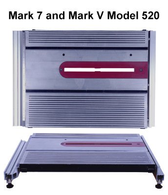

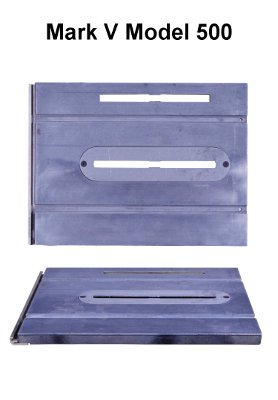

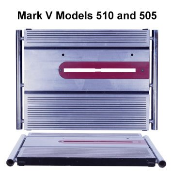

It is common to find parts with used Shopsmith Tools that do not go with that particular model or even non-Shopsmith parts. It is uncommon to have, as in your case, the later models Saw Guard Set with a Mark V 500. That has me wondering if your Mark V has the original Table System or was upgraded to a later Model Table System. That would make having the shorter Arbor with the later Saw Guard set more likely. The pictures you posted showing the Arbor/Lower Saw Blade Guard issue are great but not shown yet is the Table System you have. Below are pictures of the three Main Tables for the Mark models.
The first is the Mark V 500 AKA original Mark 5.

The Main Table above happens to be from a 1960's or 1970's Mark 5 with the extra Table Slot not found on all early Mark 5 (1950's) and Mark V 500 (1980 or later) tools.
Below is a Mark V 510/505 example and is a later one. Early ones had ribs all the way across the Tabletop. It has the round tubes for Fence Rails.

The Mark V 520, 520S which also includes the Mark 7, new Mark 5 & the discontinued Mark 4. The Fence system changed to the Pro Fence with extruded Aluminum Rails and a wider Fence. The Table itself is the same as the Mark V 510/505 model.
