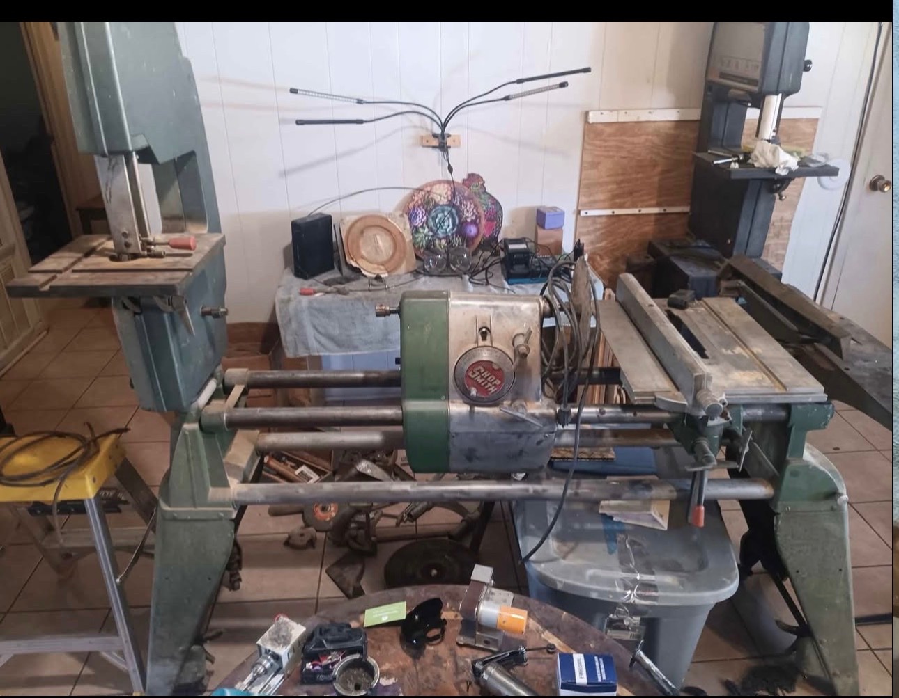

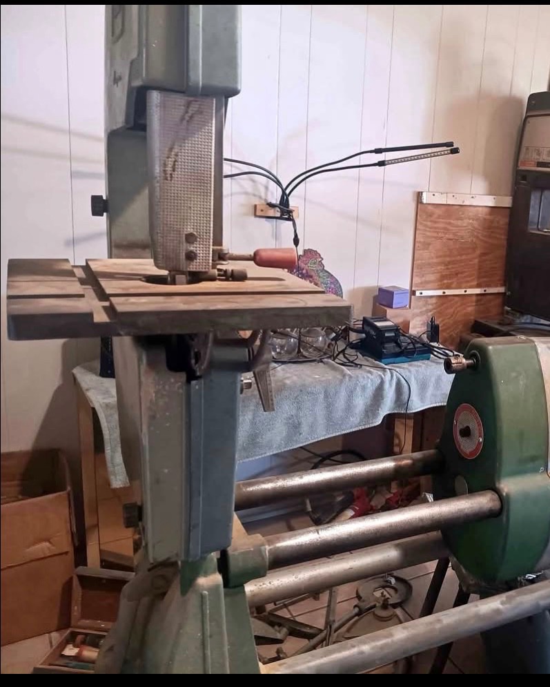

Hi everyone. I would like to add a bandsaw to my Shopsmith. I can’t find any newer models for sale in my area but I did find this really old one. Is it worth buying?

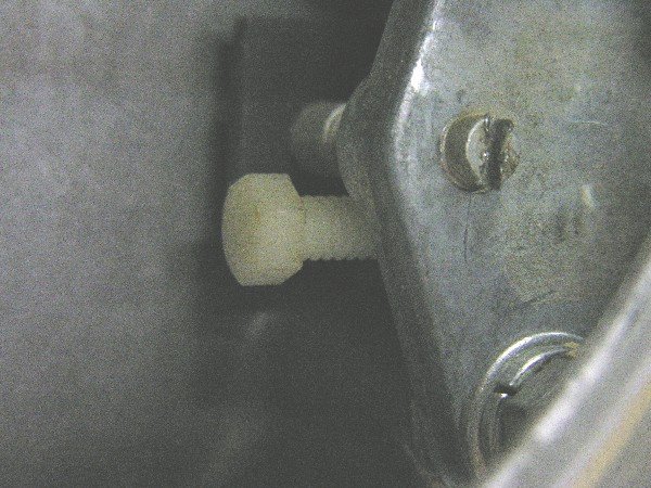

As for the Greenie Bandsaw in the pictures, it is a good Bandsaw like all years the Bandsaw has been made beginning in 1955. That said, it has the Cast Iron Table as opposed to the newer Aluminum Table. Both have their pluses and minuses. Unless upgraded it would have the old Roller Guides in the upper and lower Guide assemblies and the auto tracking roller. These are in need of very regular attention to cleaning and lubrication. It can be upgraded to the new guide bearings. Age may require replacing the tires on the upper and lower wheels. There have been other changes to the Bandsaw over the years. One was the addition of a nylon screw added to the Guide Column Bracket as show below. It helps with stabilizing the Upper Guide Assembly.
_
Guide Bracket.JPG (75.17 KiB) Viewed 84935 times

You did not say the asking price and it is a bit hard to tell from just a couple pictures its true condition. Both the upper and lower Wheels should turn freely and smoothly. If not the bearing in the lower Wheel may need replacing. The upper Wheel has needle bearings that need periodic lubricating (grease) and if worn or damaged the upper Wheel may need replacing. You could spend more money bringing it to a better condition than getting one already to use in good operating condition. As an example, I have a 1998 Bandsaw which has the Aluminum Table ready to sell. I would sell it for $200 which is comparable to ones found at times here in the Northwest.

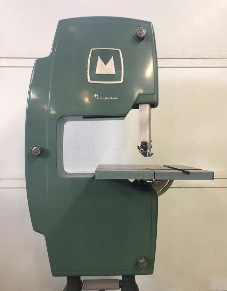

One of my Magna/Shopsmith Bandsaws is a 1956 Greenie I restored to original condition. It runs as well as my main Bandsaw with the Aluminum Table and the current upgrades.
_
Model 630 SN 22784.jpg (66.3 KiB) Viewed 84935 times

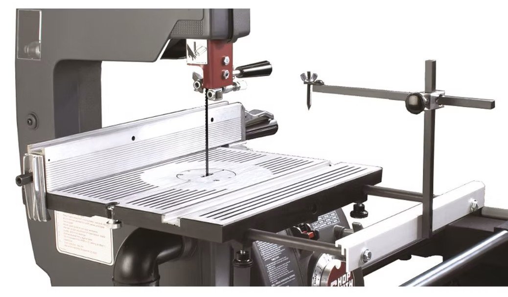

Aluminum Table Upgrades.jpg (81.98 KiB) Viewed 84842 times
