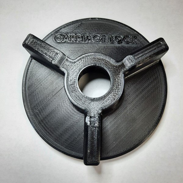

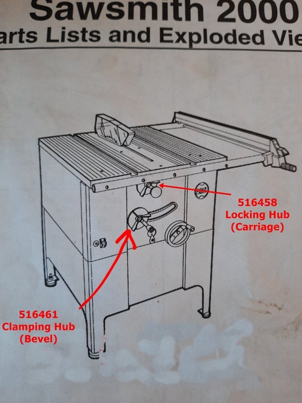

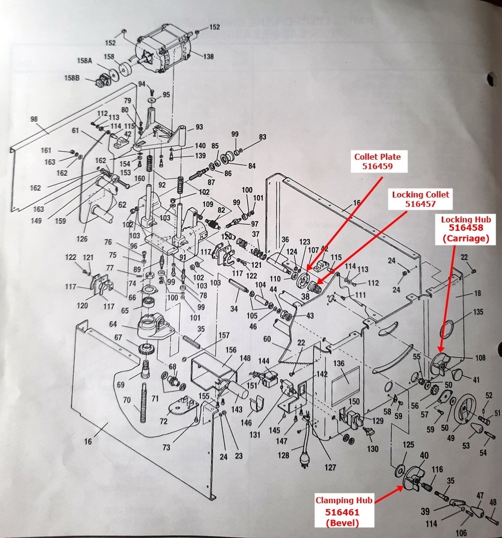

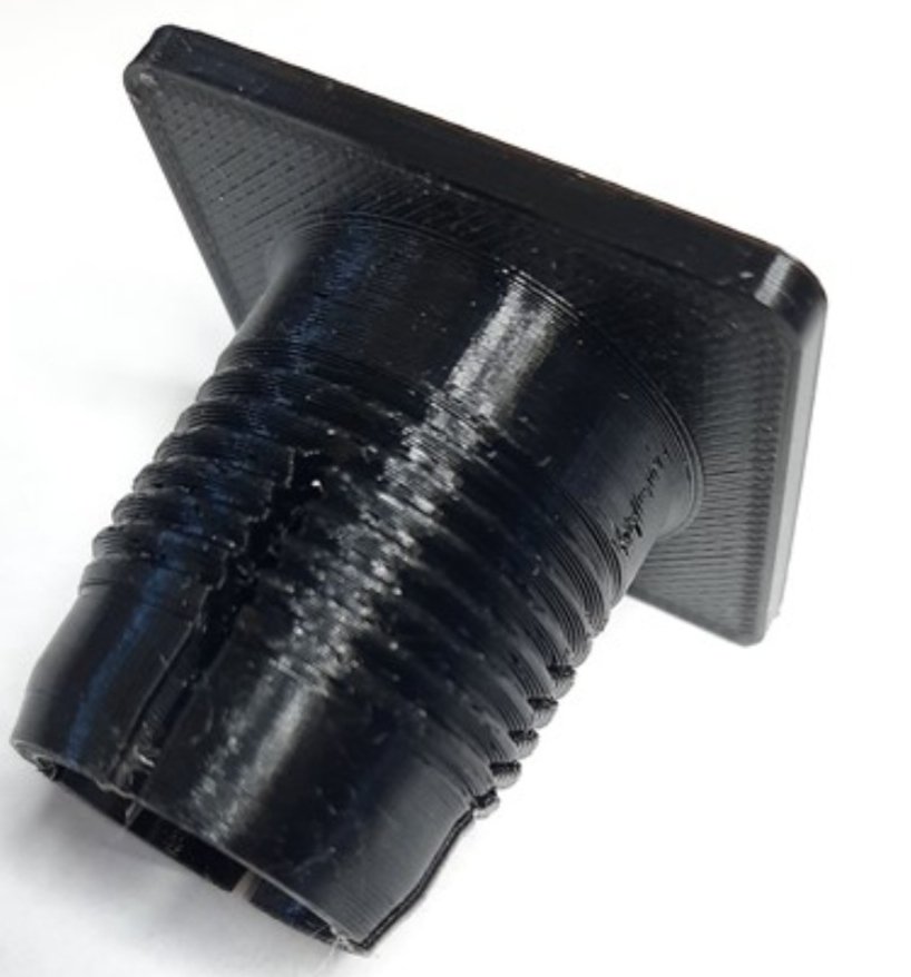

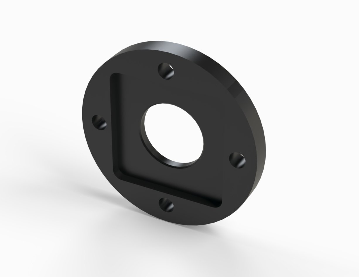

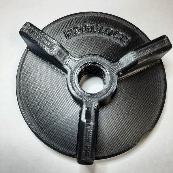

For anyone who owns a SAWSMITH 2000, you know spare/replacement parts are hard to get. I have a standard MODEL (555530) I've owned for over 25 years (and I got it from my father-in-law when he closed up his cabinet shop.)
Anyway, I used to run a 3D CAD design business, so recreating some of the hard to find parts and then printing them in PETG plastic (strong like ABS and also UV resistant) on my 3D printer has been very useful.
I thought I'd share some of the parts I have replaced so that if any of you SAWSMITH owners need a resource, I might be of help. I've added images of the parts I've developed and can 3D print for you. I have had the parts on my SAWSMITH for many years now and all are working fine. I've sold dozens of these parts over the years with no warranty returns to date. If you are interested, send me a note.
Parts:
516458 Locking Hub (Carriage Lock)
516461 Clamping Hub (Bevel Lock)
516457 Locking Collet
516459 Carriage Collet Plate
Send me an email note at chadwallsvcs AT gmail.com

- SS2K Bom 1 (for reference)
- SS 2000 Exploded view 1.jpg (78.19 KiB) Viewed 6620 times
- SS2K Bom 2 (for reference)
- SS 2000 Exploded BOM 2.jpg (220.98 KiB) Viewed 6620 times
- 516458 Locking Hub (Carriage Lock)
- Sawsmith Locking Hub 516458 - carriage lock.jpg (92.07 KiB) Viewed 6620 times
- 516461 Clamping Hub (Bevel Lock)
- Sawsmith Clamping Hub 516461 - Bevel Lock.jpg (102.3 KiB) Viewed 6620 times
- 516457 Locking Collet
- 516457 Locking Collet.jpg (61.07 KiB) Viewed 6620 times
- 516459 Carriage Collet Plate
- SAWSMITH CARRIAGE COLLET PLATE 516459.jpg (29.37 KiB) Viewed 6620 times
