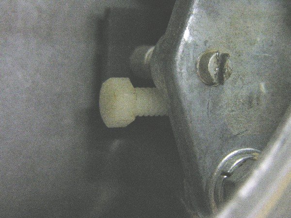

Something the early Bandsaws did not have is the Nylon Bolt (shown in the picture below) as part of the Guide Bracket Assembly. It helps with the alignment of the Upper Guide Assembly and can be added to an existing Guide Bracket by drilling and tapping a hole to add the Bolt or purchase a Guide Bracket Assembly that has it.

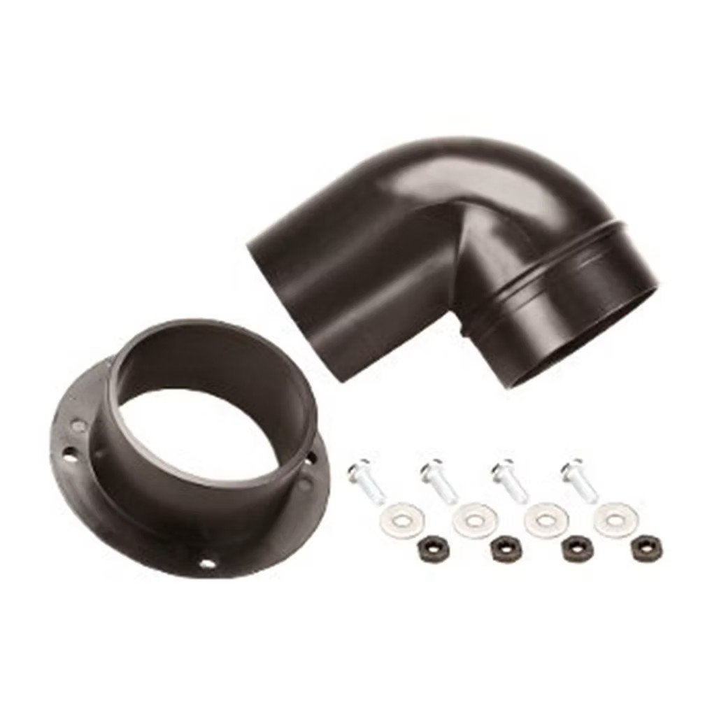

One upgrade I did not mention before is the changes to the Cover. Two great upgrades have occurred over the years. The first was the addition of a Dust Collection Port. There is an upgrade kit available to add to older Covers. New Covers have it molded in as part of the Cover. The other change to the Cover was the addition of a window and slot in the cover side to allow the tension to be adjusted and seen without removing the cover.
Below is the Dust Chute upgrade parts.

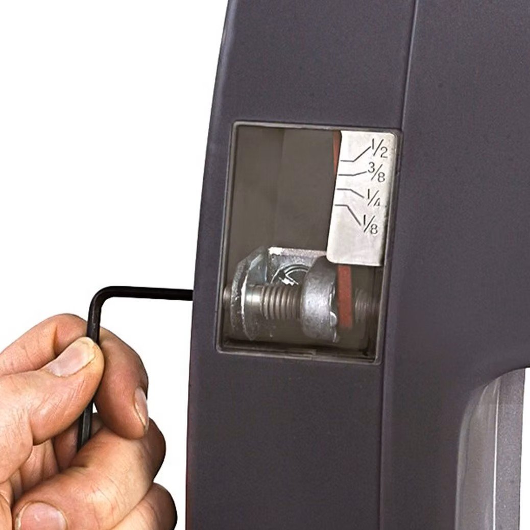

The picture below shows the Window in newer Covers. The window can be added to older Bandsaw Covers by ordering the window itself and cutting the opening in an existing Cover. The slot on the side of the cover for the Allen Wrench can also be added. Some owners have added this to their older Covers.

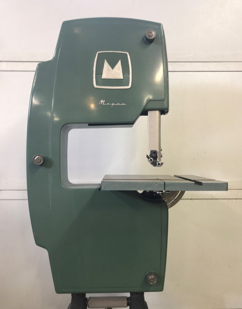

The Cover size has not changed so a new Cover can be purchased to add the Dust Collection and Tension Adjustment features to an older Bandsaw. The new Cover will not match the color of the older Greenie and Goldie Bandsaws. Below you can see the newer Cover on a more recent Bandsaw. The Dust Collection port is just below the Table. Something you may also notice is how the Cover is held on to the Main Frame. The Knobs have been replaced with washers and Screws. The Post also changed to accommodate the screws.
