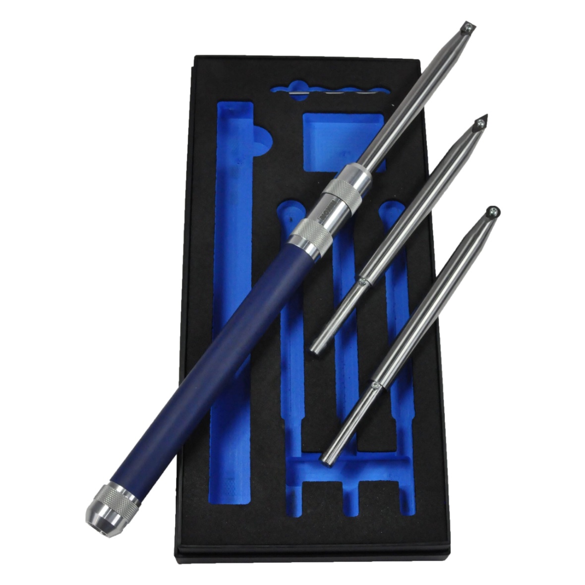

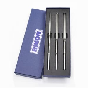

Thanks for the info Jim. After posting I went shopping and bought these from Rikon. Buy once, cry once. The second photo are the bowl gouges.
- IMG_2518.jpeg (165.42 KiB) Viewed 6774 times
- IMG_2519.jpeg (14.49 KiB) Viewed 6774 times
