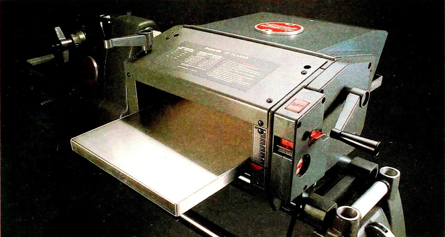

There was a Manual Feed available for the Planer but is not commonly found. The Crank Assembly went in place of the Feed Motor and Mounting as seen below. These rarely come up for sale on the used market which is the only place to find one. It would take some definite creativity to make a Hand Crank Assembly for one. You are correct in that it would be expensive to buy a replacement Feed Motor. I have seen one for sale but high priced. You may want to consider having the Feed Motor you have checked to see if it can be repaired or is the control box the problem. You didn't say if your Planer is a Mark Mount or the Pro Planer on its own stand.
_
Photo credit Everett Davis
1st Shopsmith Thickness Planer with Manual Feed 505980-B [1986] Everett.jpg (261.75 KiB) Viewed 613 times

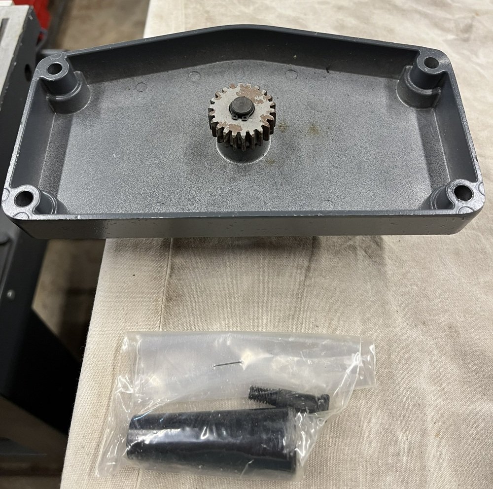

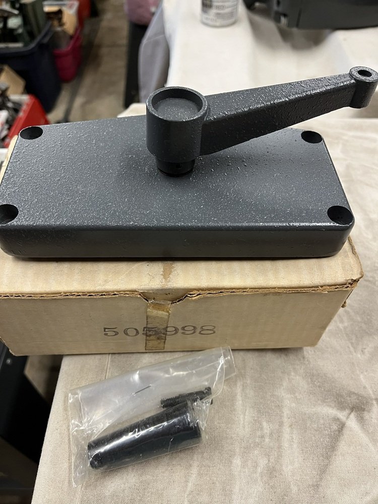

Here are a couple pictures of the actual Manual Feed Assembly. The Handle and Screw are in the plastic bag.
_
Manual Feed 505998.jpg (153.3 KiB) Viewed 480 times
Manual Feed inside.jpg (233.11 KiB) Viewed 480 times

that is very, very helpful. Can I ask what the parts are that are in the plastic bag at the bottom of the photographs? I presume it's the handle for the arm.
