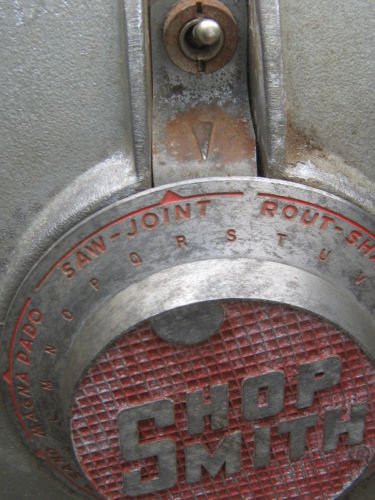

I suppose this has been asked several times , it turns out the greeny I thought was a goldy is once again a actual greeny , once I got the covers off some actual original paint was exposed . I hate to repaint the thing because of the patina , its almost like erasing its past . that said I want to make it good for the future , a couple new belts and a good lube and cleaning is under way , is there a source for the hammerd paint ? Tanks Bill

I have managed to get the belts off there is some damage to the bearings so I am have ordered a set , as far as the numbers go I havent seen any any where . I was looking at the numbers on SS page and see where between 1962 there isnt any number data . it has a very old looking franklin motor .

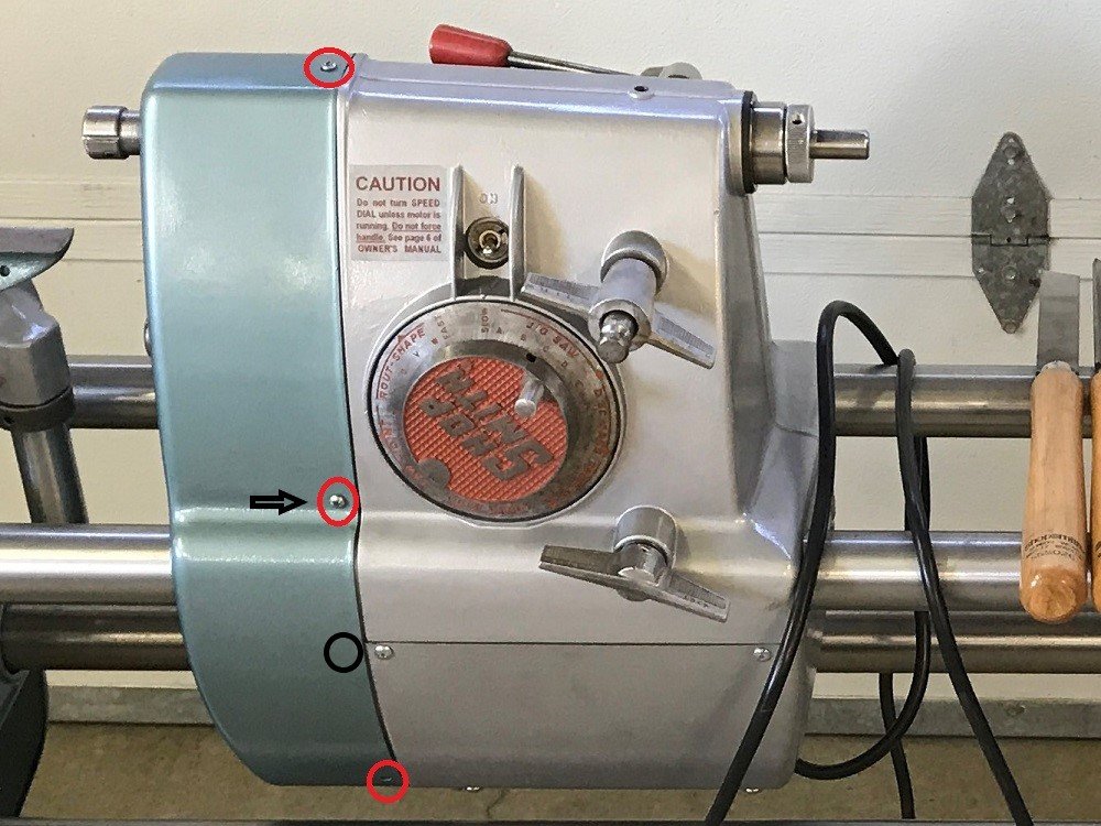

If it is a Greenie they were made from before the introduction of the Mark 5 in March 1954 until February or March of 1960. There are some things specific to the Greenies as changes were made. The first is the Headstock casting itself. The "A" Headstock was made until October 1955 when the "B" Headstock was introduced. The first telltale sign a Greenie Headstock is the "A" Headstock is the High-Speed Lock seen below. It's that little metal tab held on by the Switch that must be pushed in to go into the higher speed range.
_ .
Other outward signs of the age of a Greenie Headstock is how many screws were used to hold on the Belt Cover. The first Headstocks had 8 screw that change to 6 screws in 1955 before the change to the "B" Headstock. In 1957 it changed to 2 screws to hold the Belt Cover on the Headstock. In the picture below of a "B" Headstock the red circles show the locations for the 6 screw which includes the bottom and back side. The black circle indicates the additional 7th and 8th screw's locations early "A" Headstocks. The Black arrow is where the 2 screws are located to hold the Belt Cover on beginning sometime in 1957. (I know I am making this pretty basic but others less familiar with Shopsmith Mark V's may find it helpful.)
_ .
Another big difference the Greenie's had were the Bench Tubes being 1-7/8” diameter going to 1-3/4” diameter for the Goldie's. I am not sure how many Goldie's may have been made with 1-7/8" diameter Bench Tubes or if any of the last Greenie's had the 1-3/4" Bench Tubes. It is these 1-7/8" Bench Tubes that warnings in upgrades about pre 1972 Mark V's require additional changes come from.
A couple of changes occurred to the Main Table during the Greenie era. The first in 1957 was the Fence Rail became a separate part bolted onto the Main Table. Up to that time the Fence Rail was a part of the Main Table casting. In 1959 the extra slot was added to the Main Table which was a feature of the Mark 2.
These easy to see differences can help determine an age range for the Mark 5 Greenies. There are additional internal Headstock differences that can narrow down the age of a Mark 5 Greenie.
All this is true only if the parts are all original to when a specific Greenie was made.
As for getting parts for the Mark 5 Greenie's, they can be found but original ones to match may take patience. The Greenie Headstock shown above is from one I restored that took me a while to find all the correct parts I needed to get it back to original condition. One thing that can save these older Mark 5's is upgrading with more current parts. As an example, I have even seen where a Power Pro motor has been added to a Greenie.
