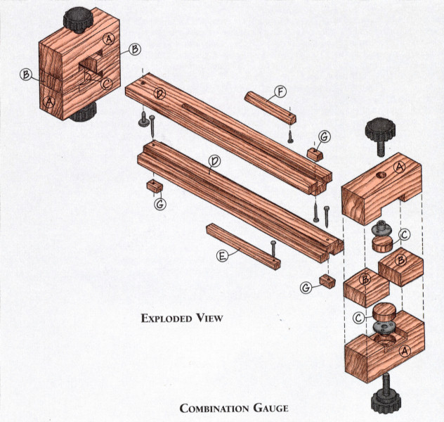

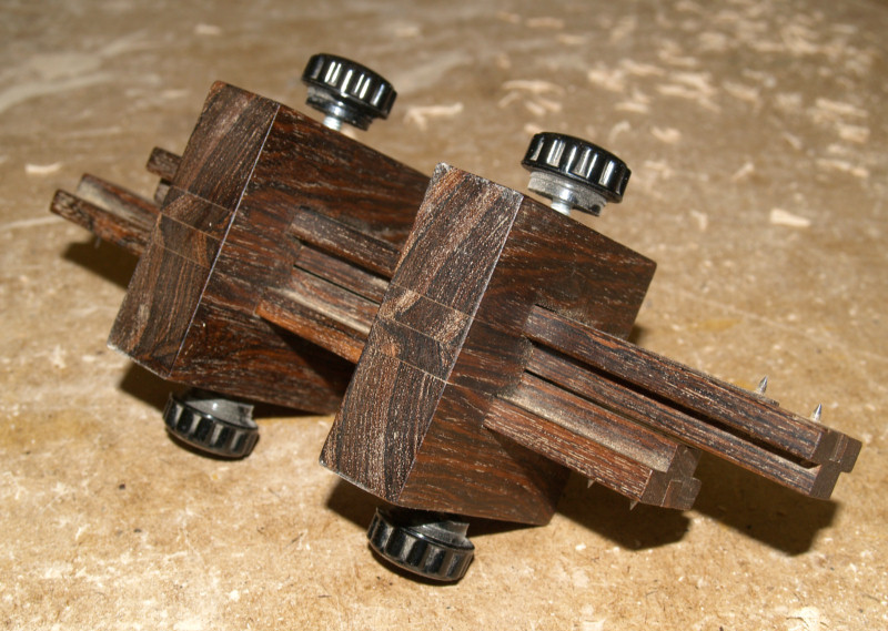

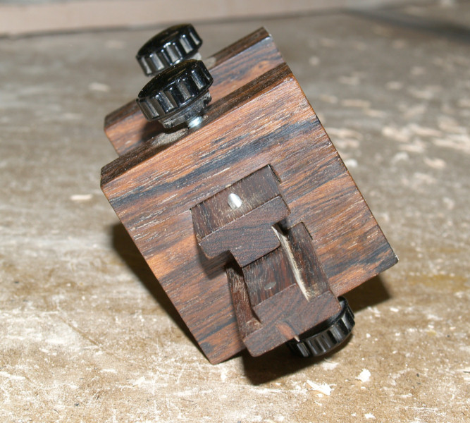

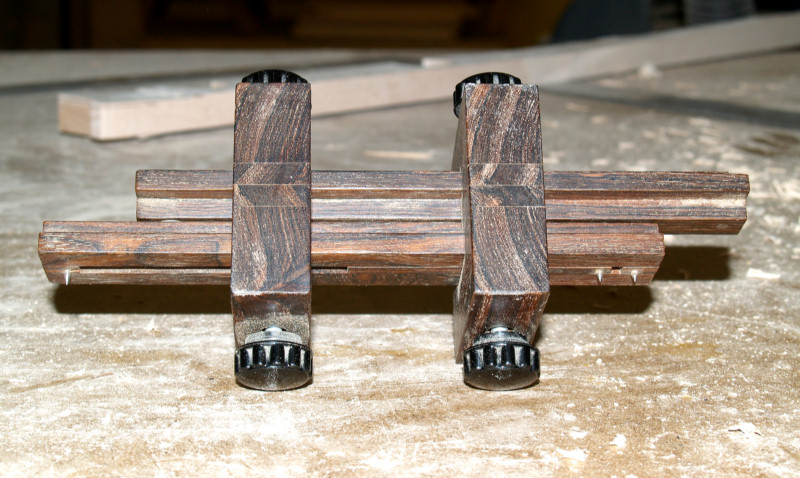

About the best marking gauge I have is one that Jim McCann (who wears too many hats here at Shopsmith to count them all) made for me. It appeared in my book "Using Hand Tools." It's a "combination" gauge, so you can set up to score up to three different lines, and two of those can be sets of parallel lines. It's impossible to find a marking gauge as useful or as versatile on the commercial market.
[ATTACH]137[/ATTACH]
[ATTACH]138[/ATTACH]
[ATTACH]139[/ATTACH]
[ATTACH]140[/ATTACH]
[ATTACH]141[/ATTACH]
We're getting a syllabus for a "Making Hand Tools" course at the Academy, and this will be included, most probably.

Holy Katts!!!! Now I know why I spend as much time on this site as I do. That is a neat project. I have been looking for one of those gages for years. What kind of wood is that make from?

The gauge is made from wenge, Mark. And thanks for your kind words. Thanks for yours too, Spike, although I'm not sure that "gizmosity" fits in the "Kind Words" column. However, it certainly fits under "Cool and Confusing." Rest assured that I will weave that one into my sampler.

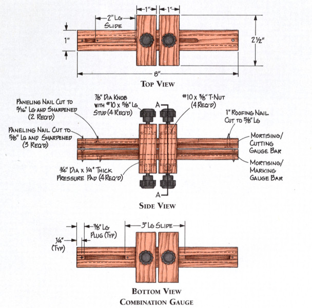

That gauge looks fantastic. Are there plans I can buy to build one?
billy wrote:That gauge looks fantastic. Are there plans I can buy to build one?
Methinks post #3 is as close to one as you will find!
Ron309753
Posts: 355
Joined: Tue Jul 01, 2008 10:25 pm
Location: Marengo, OH
Post by Ron309753 »
The plans are in Nick's Using Hand Tools book, which is one of the books in The Workshop Companion series. I don't know if it was published anywhere else. I don't think you will find it anywhwre else but Amazon: http://www.amazon.com/gp/offer-listing/ ... er=&colid=
