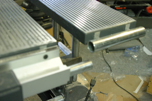

To clarify why the 520 & 510 rails don't go together.
The main and aux table are the same height in the picture below.
[ATTACH]5451[/ATTACH]
- ss9.jpg (42.64 KiB) Viewed 4975 times

gregf wrote:To clarify why the 520 & 510 rails don't go together.
RE: Your signature line; I am not convinced it is God who is creating the 'better' idiots!:rolleyes:
Please correct me if I am wrong.
I have always thought that the tables on the 505/510/520 were the same (interchangeable) with the "major mounting differences" brought about by the rails used. Am I wrong?
