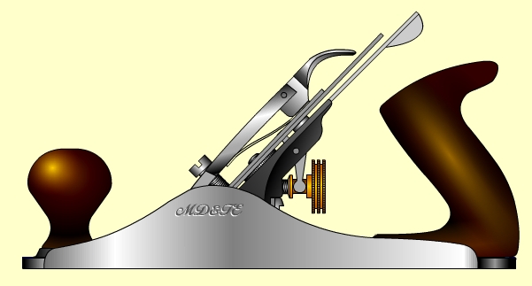

These still work very well.
[ATTACH]6836[/ATTACH]
- Smoothing_Plane.jpg (66.31 KiB) Viewed 15761 times
I've seen one of those before, but I couldn't find the "On" switch. There was no power cord so I'm assuming it uses a battery, but I couldn't find where to put the battery either.
But seriously... I have an old Stanley #5 plane that is in bad shape. I've disassembled it and removed the rust and gunk, but that's as far as I've gotten with it. Having never used one before... I understand how it gets one piece of wood smooth and flat. But how do you get two pieces of wood to the same thickness with it?

Lots of books on hand tool use out there...and any one worth its salt can answer your question. The procedure, in brief is: Flatten a face then flatten an edge. In other words, the same two steps you did to your stock before taking it to the saw...If it were me doing it, I would use the jointer for these steps, just as you did. Then, to minimize the amount of planing you will need to do in the final step, rip the second edge parallel to the first and cross cut the stock to length or a bit over to allow for finishing. Now, here comes the hand work part...using the flattened face and a marking gage, scribe a line on all 4 edges at the desired final thickness. Plane away the material above these lines. Typically the material is "hogged off" using strokes diagonal to the grain and a coarse blade exposure and then finished with strokes parallel to the grain and a finer set to the blade. Then you do the same thing with the second piece, using the same setting on your marking gage.
I have gone through this process a few times in building small tables. The slight "waviness" in the table top adds to the piece's charm, imho, but if you really need an absolutely dead flat surface on a board of absolutely uniform thickness, you will either have to discard your first few attempts while you serve your apprenticeship, add the SS planer to your shop or wait until HD puts a benchtop planer on special!
