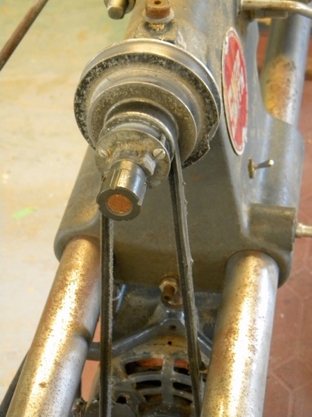

Check this thread for a very simple and elegant SPtmount that came with shipwright's ER acquisition.

Thanks Heath, you saved me a post but I can add one more photo.
[ATTACH]7232[/ATTACH]
This is the shop made drive hub attachment that came with the SPT adapter. It is a short shaft locked into a pulley that is then tapped and bolted into the existing pulley. The pulley cover will have to be altered or removed to do this. Looks suspect to me but if it was done by the same person that concieved of the adapter and the copy lathe I wouldn't knock it until I tried it (which I haven't had time to do yet)
