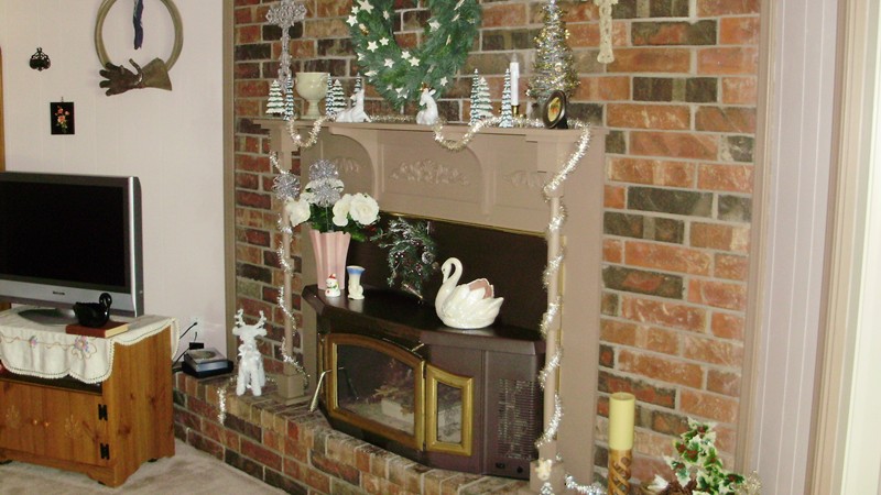

Uh, I don't know, Heathicus. It looks really nice to me. This is the one I just did recently.
https://forum.shopsmith.com/viewtopic.php?t=4233

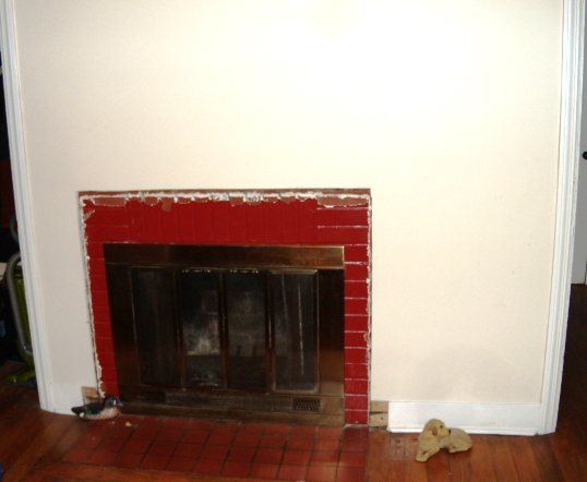

Thanks, I will check with the code dept. I like the ones you all have done. We just redid this wall, I still have to take the old paint of the brick. I may tile over it. As you can see the fireplace is not centered. It would be easier if it was. I think I want to go from door to door. Building a inset for the fire place tools on the right. Old house. Nothing is square! I will post as I go.
[ATTACH]7292[/ATTACH]
- fireplace 002.jpg (136.92 KiB) Viewed 4719 times

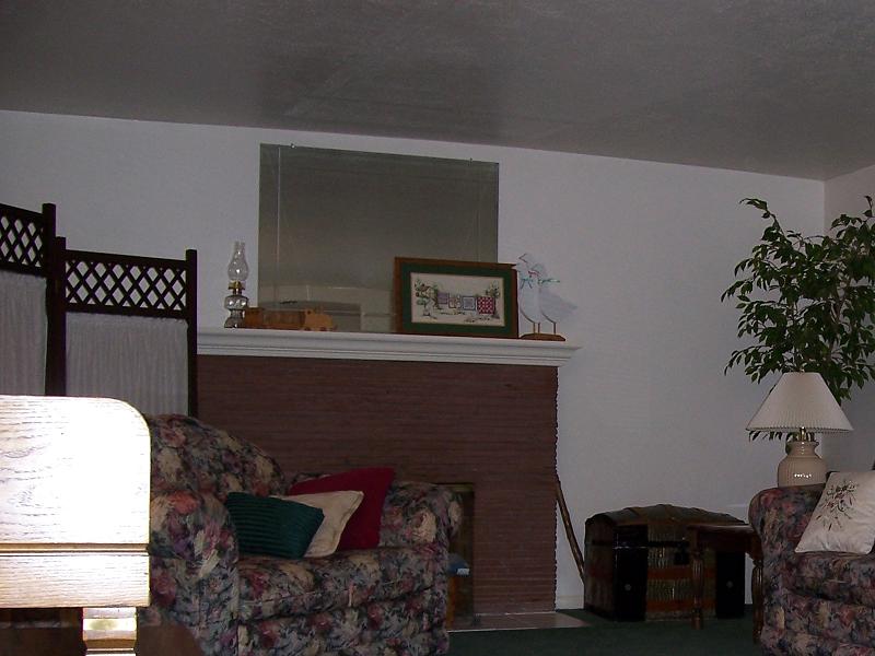

Just make sure you meet the local fire codes. When I built my mantel, I used MDF for the main structure and used different off the shelf moldings from Home Depot. Mine was painted.
[ATTACH]7313[/ATTACH]
- mantel.jpg (61.78 KiB) Viewed 4685 times

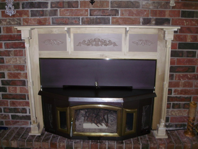

Here is another example for you. I built this out of poplar and have since painted it. Started out using sketchup for SHMBO to approve of the design first. She ended up loving it. I did not know about codes about fireplace mantles?? In the country I don't think it is a problem but I am curious about the things they are concerned about. Mine is free standing the spindle legs sorta hold it in place.
- P5300013.JPG (80.23 KiB) Viewed 4592 times
- P1100021.JPG (106.36 KiB) Viewed 4568 times
