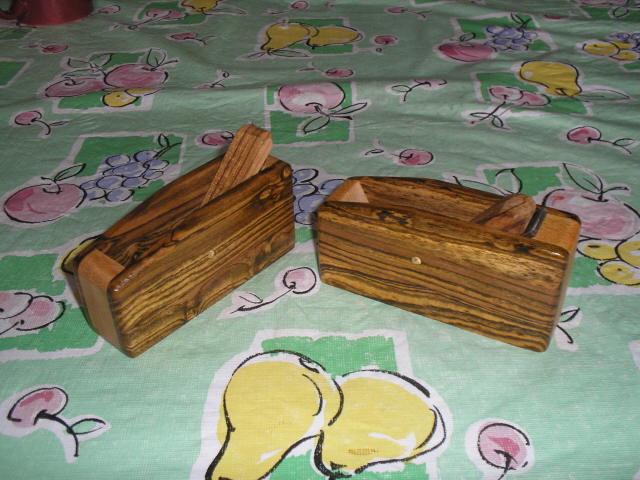

Slightly Bigger Finger planes
I just knocked these out this week; doing small stuff until I decide on some other winter projects such as a medicine cabinet.
All the side woods were cut from 3 Bocote pen-blanks glued together. The inner structural wood is 100+ yr-old beech from an antique plane. The retaining wedges are Zebrawood. There is a 3/16" brass rod in each, along with a Krenov-style wooden pivot-piece that faces the wedges for nice retention.
The blades were both cut from that same 100-yr-old bigger plane-blade. A hacksaw did not do. A Dremel cutoff wheel did only a little better. I finally used a carbide-grit-cord type of blade in the hacksaw frame -- that was good!

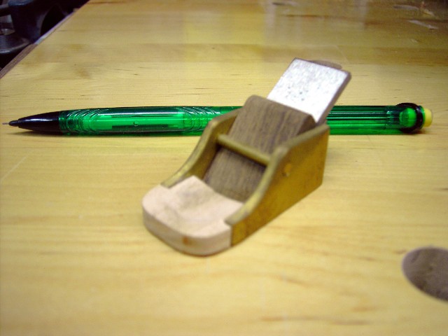

Very nice little planes, Chris. Here is one I made just after the plane making video was posted. In case anyone wants to build one, I got all the metal parts (brass plates, rods and blade steel) from McMaster-Carr.
[ATTACH]10746[/ATTACH]
Here are the directions and plans I downloaded from Nick Englers Workshop Companion web site...
[ATTACH]10747[/ATTACH]
[ATTACH]10748[/ATTACH]
