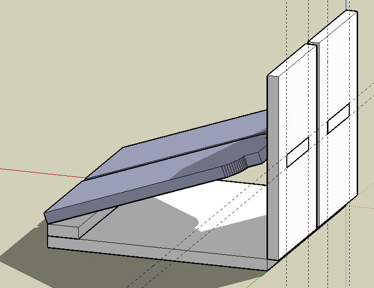

  2. Once one or more items are grouped, I tried to punch some rectangular holes though the boards that make up Group C (see attached) but can't get the extrusion tools (follow-me or push-pull tools) to work properly. Is this because the rectangular shapes are not part of Group C or something else?
I've attached my project drawing so you can see it directly along with a picture showing what I'm doing..

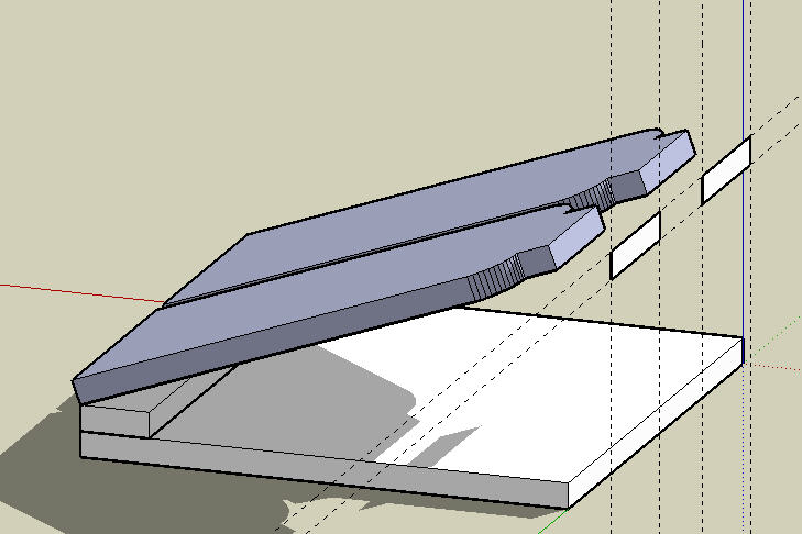

You can see that when I remove Group C from the rendering that the rectangles remain in place.. I suspect this is related to the problem.. Correct?

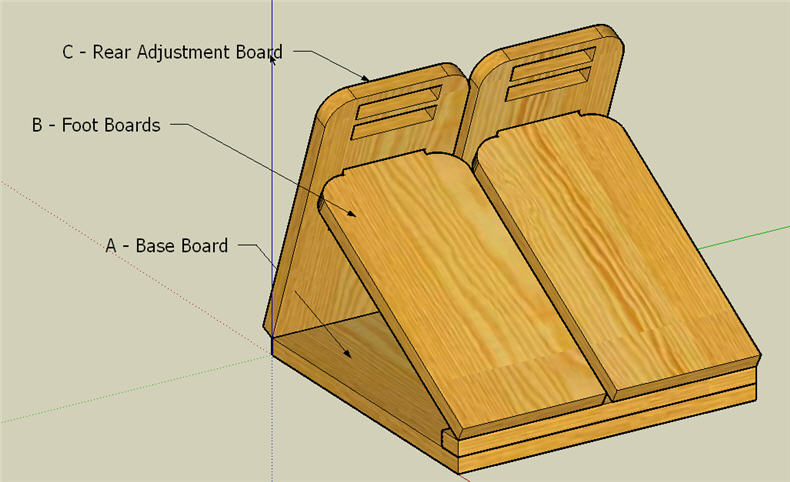

This is the goal I'm after with the foot board poking through the angled back board.. There will be several more holes in the back board to allow various angles for the feet..

Rick yes, once you've grouped some entities, you are able to edit/modify that group without effecting everything else. You do that by double-clicking on the group, and it "opens" the group for editing, and everything outside that group is grayed out. Once you're done editing the group, just click outide the group to "close" the group.
To use the Intersect tool or follow-me tools to work on the grouped entity, you again, have to open the group for editing first.

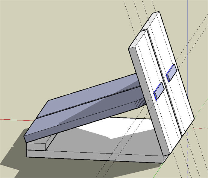

Rick: Lots of ways to accomplish what I believe you are trying to do. My fast without a lot of thinking approach would be as follows based on your file which I used note all my steps. There are other methods that work but they also take a bit more time to get right. Using intersections and deleting things for instance. I use this method too, but then I usually delete one or two lines incorrectly and have to back track myself. When dealing with simple rectangles the rectangle and push pull is my go to approach for intersections.
Ungroup your groups and make components out of the two parts: (angled piece and vertical. Delete the second pair as we'll make a copy from the completed ones at the end.
Next rotate the angled part to horizontal, it was angled at 20º in your file.
Slide the horizontal to the intersection with the vertical part so the tenon extends through the vertical.
Open the vertical component, draw a rectangle around the tenon. Use Push/Pull and push the mortise through the vertical part.
Close the component.
Select both the horizontal and vertical components, and rotate back the 20ºs
Select the pair and using the move/option commands, make a duplicate in place of your second set of components, (your file)
You can clean up the ends with beveled cuts to complete a nice unit.

Thanks guys! I was able to get things in a pretty good shape for my first project! I'm attaching the updated version of the file for your reference.. Now to try scaled printing. :D
[ATTACH]8992[/ATTACH]
Almost forgot the picture...
[ATTACH]8993[/ATTACH]
