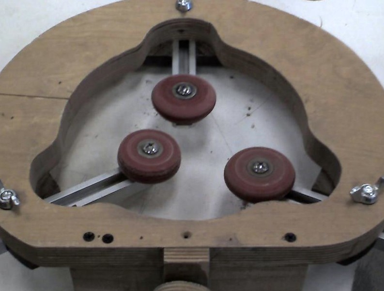

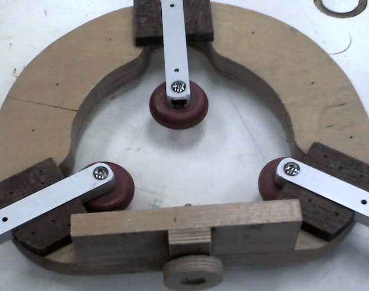

Here are a couple of photos of a steady rest that is used at Cerritos College. these were built by one of the instuctors, Jim Diskell. I took the photos with the intention of copying and adapting to the SS. Unfortunely, between work and health issues, I haven't had time to draw up any plans yet. So if photos will have to do for the moment.

I have the Shopsmith one I use for small turnings but have always wanted to build one shown by jdramsey. The biggest is for me is I have no metal working ability and don't know where to get the silver colored parts shown in all the pictures. Below are a few designs I have been looking at.

paulmcohen wrote:I have the Shopsmith one I use for small turnings but have always wanted to build one shown by jdramsey. The biggest is for me is I have no metal working ability and don't know where to get the silver colored parts shown in all the pictures. Below are a few designs I have been looking at.
The silver colored parts that you refer to are part of a t-track system that you can pick up at Rocker or Woodcraft. I caught my instructor at The Woodworking show picking up some of the tracks because it was a better price. I don't think you would need anything more than a hack saw to cut the aluminum track and a file to smooth the edges. The rest of it can be found in any hardware store. The wheels are from a child's roller skate.
