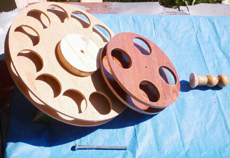

A usable Spice Rack was published in December/January 2000 Family Handyman, page 16. It was of interest because it could be rotated using Lazy Susan Hardware. Of interest was, if it could be made simpler, using fewer tools, adapted to standard containers, and use common materials.
The first change was to make it w/o the Lazy Susan hardware. The Lazy Susan Hardware was replaced with a lag screw with a protruding head that would serve as the pivot point. Solid stock was replaced with two spaced plywood disks, the upper disk to hold the container the lower disk to support the container.
[ATTACH]9545[/ATTACH]
The revision could not be made large enough to accommodate 12 containers because it would exceed the depth of upper cupboards. The height allows access to the center post and upper tier containers with sufficient overhead to turn the rack or remove a container when rack is setting in the cupboard.

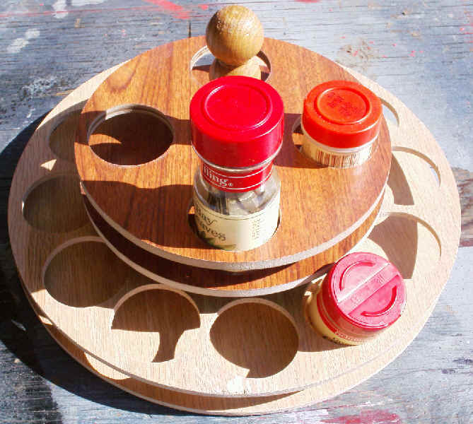

After a prototype was built. The prototype rotated easily on the lag screw head. The ¾ “ spacing to hold the containers is deeper than the original design and is a desirable feature.
[ATTACH]9546[/ATTACH]
A revised version was drawn to adapt to the common larger spice containers. The revised design holds 11 large containers. The revisions made the rack easier to build, used plywood in stead of solid stock, held the containers in deeper wells, and conserved overhead space by eliminating the Lazy Susan Hardware. A 3 “ by 1/4” lag screw .was as the pivot head. It was not feasible to place containers on the tiers because they spin off and fall behind the rack.
The disks were cut using the circle cutter and the band saw. The edges were sanded using a 1 x 4 clamped to the saw table and a pivot point in the 1 x 4. The table was moved closer to the sanding disk until the entire circumference of the disks were sanded,
