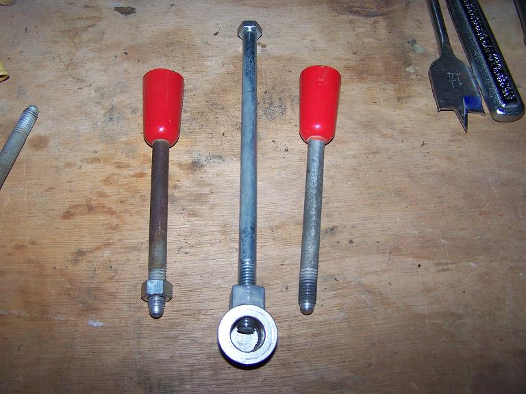

On my Greenie the quill feed handle and table height handle are identical. They are 3/8-16. You could take the table height hub into the store and try different bolts until you find the right one. You may need to grind the end of the bolt so that it holds once it's screwed in.

- 100_1363.JPG (88.47 KiB) Viewed 2494 times
got it to work
Never mind, it seems like the problem was that the old threads for the table adjustment hub had some crud in them. After cleaning it and carefully threading it a few times, it's fine. However I appreciate the info about the thread size, because I may just make a second handle for convenience.
