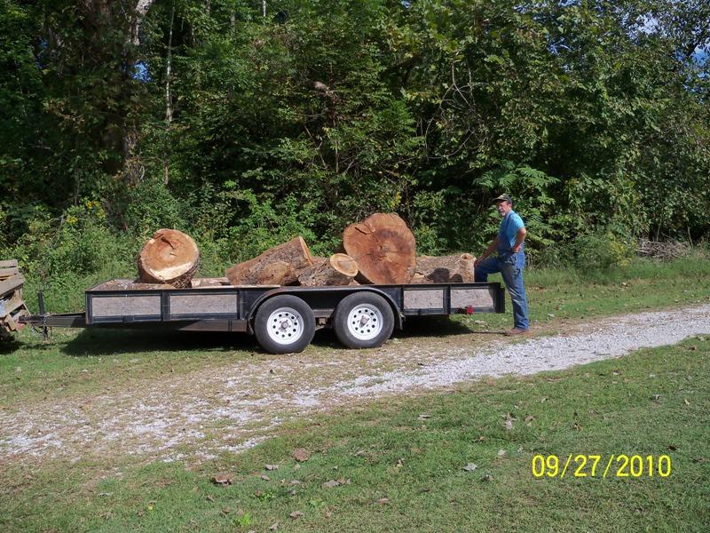

[ATTACH]10580[/ATTACH]
Sycamore, up to 36" diameter and up to 6' long. Dead tree, standing for about 2 years, cut down about a month ago.

Well, I'm just getting back into using the lathe portion of my 510s with a nice new Nova chuck and your limbs look like they would make nice blanks for bowl turning, etc. Properties seem to be generally good although reported to be a bit difficult to cut. So what you can do with it depends on how much work you can put into it as far as cutting it up. There are a couple of good books (one I'm thinking of is "Turning Bowls" by Richard Raffan) which go into some detail on cutting up logs and trees for use on a lathe - that would be a good place to start (search Amazon.com for 'Richard Raffan'). It being older wood it has a fair amount of visible checking on the end grain but that can probably be cut off. Great stuff - if you were close to me, I would come over and help you (for a few pieces of wood!).
If you decide to break it down for lathe working, you would need to seal the ends (best bet is one of the commercial sealers). Sales channels: Ebay has a lot of wood for lathe turning and Craigslist also is a possibility.
Good luck!

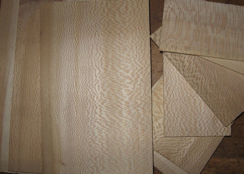

Or if you don't want to do that much turning...
Consider have some of it quarter sawn. This gives the maximum stability and an interesting grain pattern that will not appear if the logs are plain sawn. (Excepting the boards at the very center of the log) Here are a few pieces that I have for oval box making.

Take them to a sawmill. Have them sawn into boards or in the case of the largest diameter log, cut on the diagonal to make striking oval shaped pieces for table tops. Extra wide boards are very difficult to find now-a-days.
Limbs generally are not useable for wiidworking.
