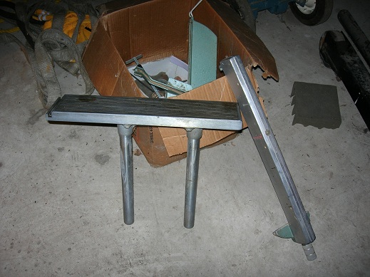

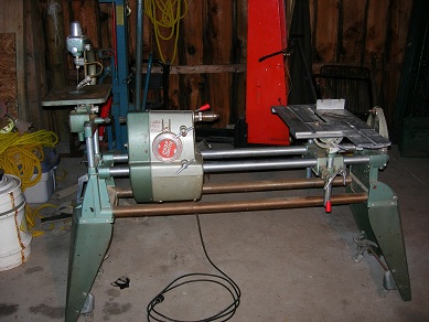

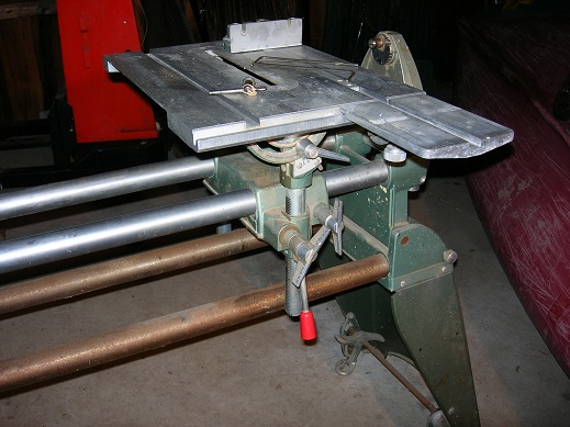

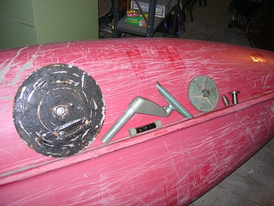

Now with Pics
As promised, here are some quick pics taken tonight.
[ATTACH]10985[/ATTACH]
[ATTACH]10986[/ATTACH]
[ATTACH]10987[/ATTACH]
[ATTACH]10988[/ATTACH]
I also spent a few minutes on the quill and spring return. Am very pleased to say that I now have spring return. Quite clean inside and it appears that someone has retrofitted the second bearing in the quill. I am also thrilled with the simplicity of the design and the ease of working on it. Once I have the high speed adjusted, everything should be grand and ready for some serious work.
Thanks again for all the help being posted. Being new to a forum and getting this quality help and comments is refreshing and heartwarming!
