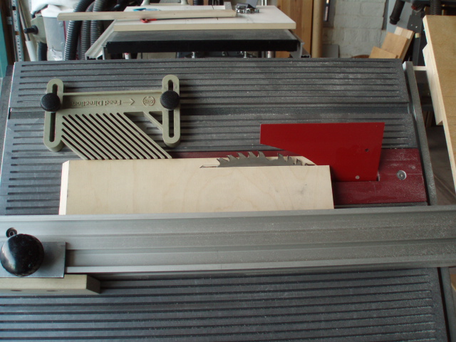

Geez! All I used to cut 4' long bevels was the Mark V, a rip fence, a featherboard clamped in front of the blade and a outfeed roller. The only time I got into trouble was when I didn't use the outfeed roller.

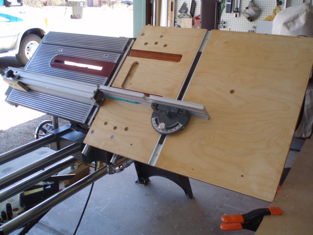

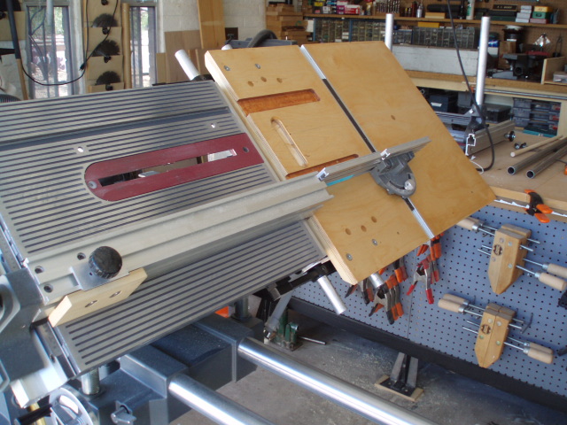

I use an outfeed table that is equipped with a board that acts as an extension of the rip fence.
Always when ripping, especially longer pieces, the riving knife must be in place.
Which reminds me: When I made the last set of ZCI I did not cut the kerf long enough to accommodate the riving knife. I need to do that so that when one day when I need a new ZCI, I am not tempted to go without a riving knife because I don't have time right then.
[ATTACH]11321[/ATTACH]
[ATTACH]11322[/ATTACH]

- Final Tilting Outfeed Table 1.JPG (151.56 KiB) Viewed 7165 times
- Final Tilting Outfeed Table 2.JPG (150.67 KiB) Viewed 7116 times

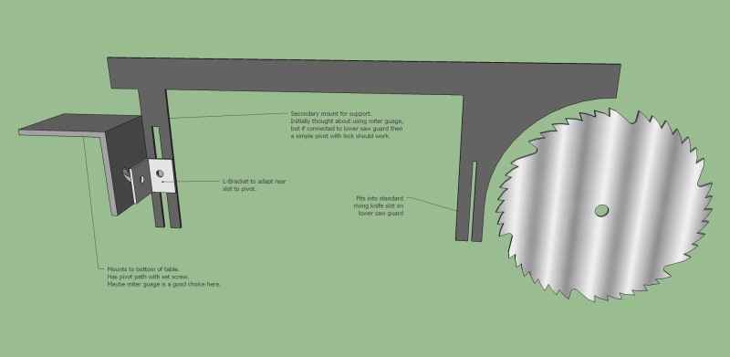

I guess my question would be since you can't really use the saw guard, why not make a standalone riving knife.
[ATTACH]11325[/ATTACH]
I didn't like the sounds of Nick's comment about needing a screwdriver to keep the kerf open, so perhaps this might work better? Table side it would use the standard riving knife connection. On the outfeed table you could use a modified version of the splitter in http://www.shopsmithacademy.com/SS_Arch ... Layout.pdf to allow it to lock in place at whatever angle...not sure how that might look, maybe some sort of L-brace attached on the back side with a curved slot and matching L-bracket + set screw.

- Riving Knife 1.jpg (44.81 KiB) Viewed 7079 times
- Riving Knife 2.jpg (34.62 KiB) Viewed 7072 times

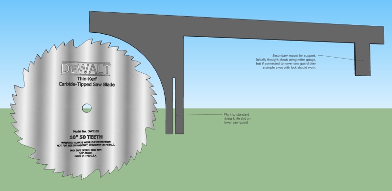

This is better than the cat's meow. I like this a lot. In fact, it has taken over a top spot on "my to do list". It will be a great improvement over what I am using now (when I don't need the upper saw guard).
[ATTACH]11327[/ATTACH]
- New Riving Knife.JPG (151.1 KiB) Viewed 7073 times

Er, uh, you might want to look at the direction of those saw teeth.

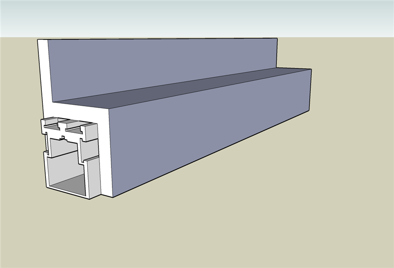

Along this line, I made and used a sacrificial fence for riping some long boards (on a bevel) for a neighbor. This drawing shows it about the same length as the Main Table but the one I used was about 6' long. It attached to the rip fence using the t-tracks and t-nuts.damagi wrote:Another thing I was realizing was that 520 users could use the back side T-slots on the fence to do the same thing as the miter guage. you could fashion a simple setup such that it could be used either infeed or outfeed...perhaps a pair if needed.
That way you are guaranteed that the fence is in line, and no worries about overtightening the set screw on the miter fence. The standard T-nut from shopsmith would work great here I think.
[ATTACH]11332[/ATTACH]
- with Sacrificial Fence for Bevel Cuts (Medium).png (58.26 KiB) Viewed 7043 times
