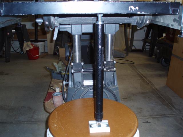

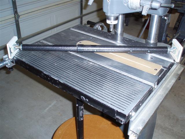

If you are doing any heavy drilling, you may discover that the Main Table sags
when you begin drilling. Now this may be because you are applying too much pressure
and not letting the drill bit do the work. But, it may also be because the table tilt lock is slipping.
To address this, I have being doing this:
[ATTACH]11334[/ATTACH]
[ATTACH]11335[/ATTACH]
The adjustable posts were originally for the slide out room on my RV. I never use them there. Now they are shop equipment.

I bet he will tell you 'any drilling that he can see the table deflect while doing so'.ryanbp01 wrote:I've always used my telescoping legs with a short tube to brace the table with when drilling with no problem. Dusty, could you please define what you mean by "heavy drilling"?

The plastic bucket is taller than a 5 gallon bucket. It is one of the buckets that my chlorine tablets come in. Yes, the lid is MDF. It was cut round on the bandsaw and then routed to smooth the edges with a straight cutting pattern routing bit and then the round over was applied. The bottom side (can not be seen) was rabbeted to fit down inside the bucket. I have done enough of these to warrant a hardwood pattern. I have a standing request with the folks who service my pool for the chlorine buckets. I used to get one or two a month. Now I'm lucky to get three in a season.Ed in Tampa wrote:Dusty

Heavy drilling is anything I might drill on the drill press in volume. I believe the table can be reflected with a lot less pressure than you might think. Rather than crank down on the tilt lock, I brace the table.
I developed this habit a while back when I was doing a lot of drilling and did not discover until late into the assembly process that my holes were NOT PERPENDICULAR to the surface. My table had tilted a couple degrees during the project. It was one of those @#%^& moments.
The bucket seats are always there (they double as places to hide stuff like small cutoffs) and I have three of the adjustable poles. One is set for the height needed and is hardly ever used for anything else.
