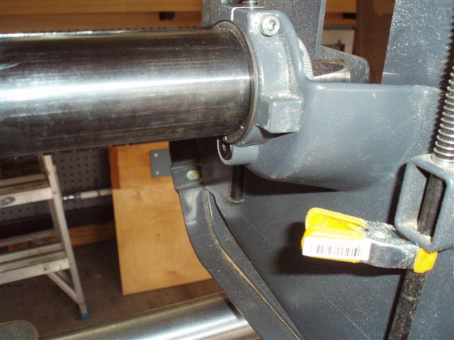

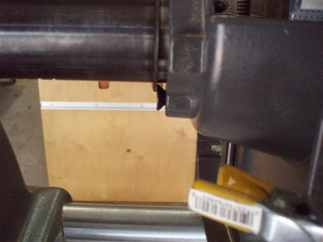

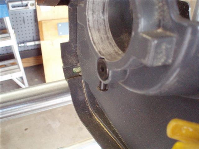

Riving Knife Adjustment
Picture anyone.
[ATTACH]11352[/ATTACH]
[ATTACH]11353[/ATTACH]
[ATTACH]11354[/ATTACH]

- P6250021 (Small).JPG (43.63 KiB) Viewed 1063 times
- P6250023 (Small).JPG (51.06 KiB) Viewed 1063 times
- P6250025 (Small).JPG (38.82 KiB) Viewed 1063 times
