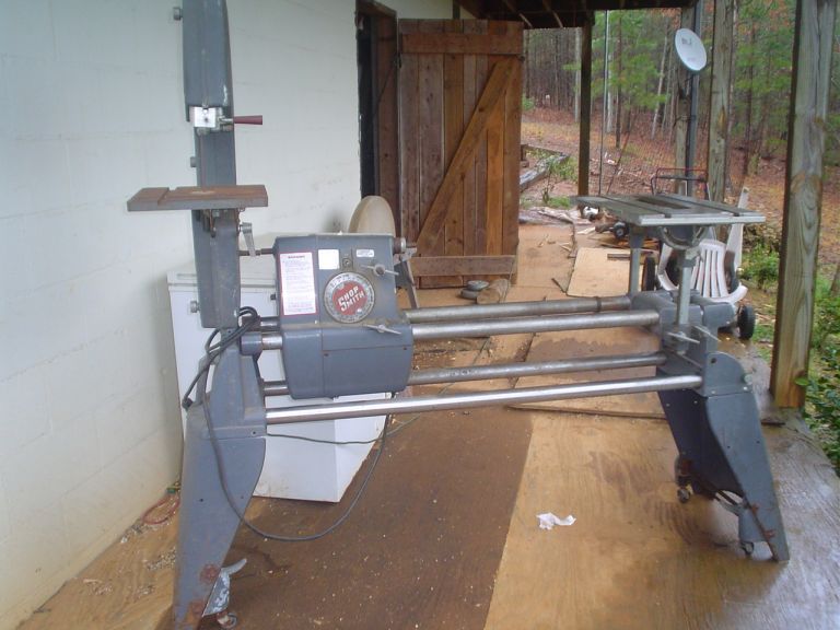

Hi all, I'm another new to shopsmithdom. A friend gave me a set of
Shopsmith lathe tools because I do carving and talked about wanting to get a lathe. So I go online to find info and come across an add at a pawn shop 5 minutes from the job we're working. They pull out an older machine with the headstock motor, tablesaw base, and a bandsaw. It runs O.K. and the saw turns freely so I got it for $90.00. The serial # is gone but the bandsaw has one ( 53206) maybe 1981?
Is this a 500 or 510? it's grey with a metal toggle switch.
I know very little about lathes but looks like I need a tail stock and center pin
along with the part for the headstock shaft.
All 3 shafts are 5/8
I done want new parts so where can I find these items at a fair price?
Any info will be appreciated.
Thanks

the headstock and main carriage are largely interchangable, so the main hting is the table system. at $90 my guess is a 500.
500 has a small table with a lip. raising the table happens via a long handle.
510 has larger table with a red insert for the blade and round tubes. raising the table uses a hand crank
520 has larger table with red insert for blade and boxy aluminum tubes. raising the table uses the hand crank

Post by crokseti »
Heres a pic

That is a model 500.

michaeltoc wrote:That is a model 500.
Yes Indeed it is! BTW you STOLE it! Congratgulations on yer good fortune.
B4 you get too far with it, here is some recommended reading - https://forum.shopsmith.com/viewtopic.php?t=7092&highlight=newowner
The tail stock, tailstock center, and the spur drives are often found on e-bay, but with shipping can become more costly than new from SS. Caveat Emptor. B4 running it much, do the lubrication bit. You know nothing re its history!
P.S. You are also missing a couple of handles/lever(the quill feed and the table elevation). They come in three different versions, stubby red, skinny red, skinny black. The shiney ventplate on the pto end(facing the bandsaw) should have either a SN or a MFG date.
P.P.S. Do you also need the lathe tool rest??

I need the tool rest also.
I fabricated a coupling to connect the bandsaw using a 3 inch nipple and set screws but I'm gonna have to weld nuts on to catch enough threads.
I'm going to the local flea market on Sat. to look for more parts before I e-bay. Probable end up fabricating a tail stock if I can't find a good deal.

Be very cautious using a rigid coupling that does not 'give' for slight mis-alignment. That would be placing the castings and bearings at risk.(as well as the operator) Replacing the lower bandsaw bearing is very pricey.

Rather than make something that may fail or not be safe, I would just buy a couple of these. I keep a couple of backups on hand in case one should fatique, but that has not happened.
http://www.shopsmith.com/ownersite/part ... xpview.htm
