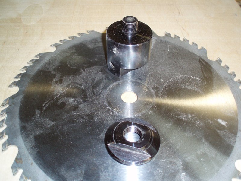

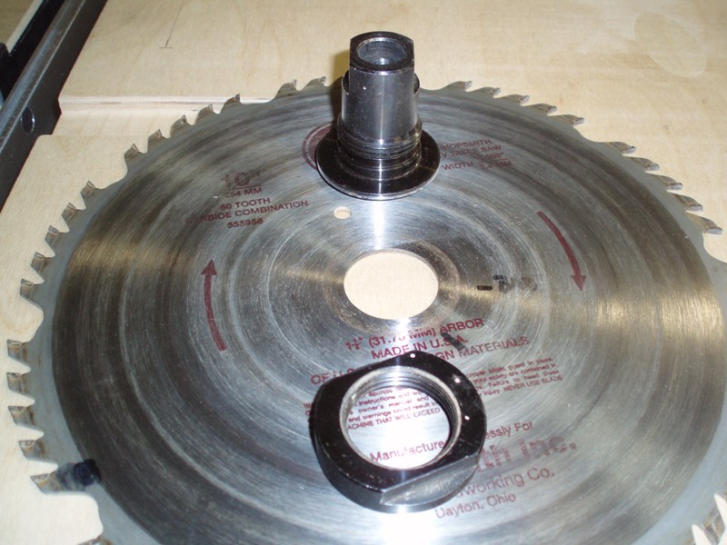

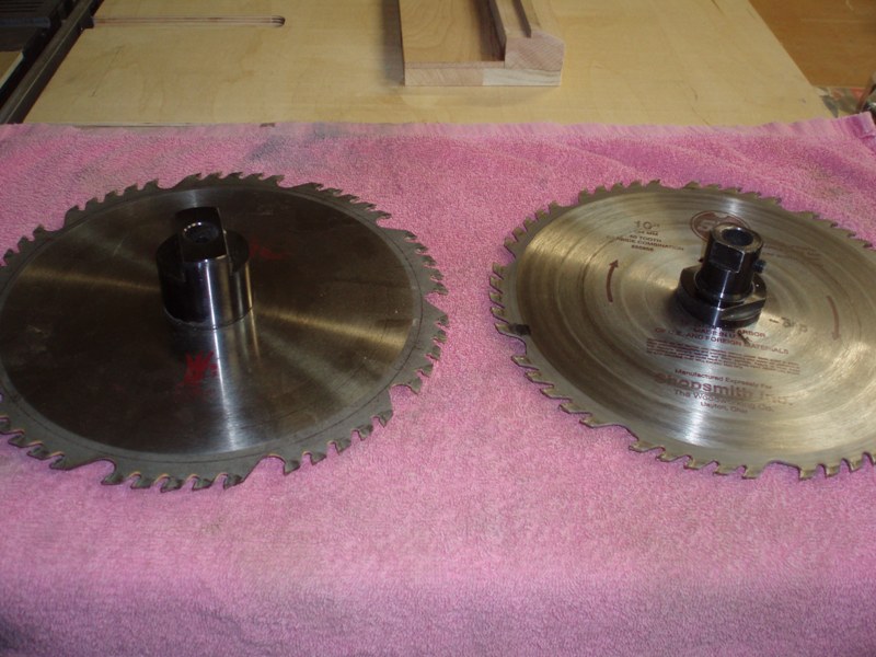

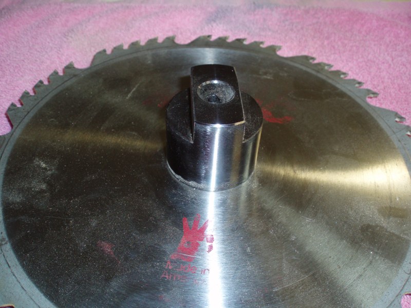

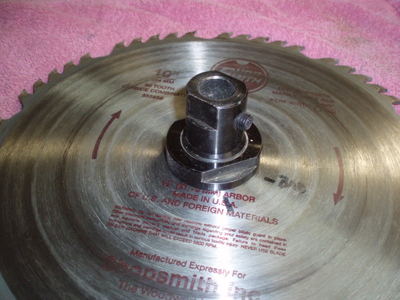

I am not certain just what JPG has in mind when he says the arbors vary between the 510 and 520 but here are some photo images of the two arbor types that I use interchangeably on my 510 and 520. They are different primarily because one is for a 5/8" arbor and the other for the 1 1/4" arbor.JPG40504 wrote:Maybe this will help.

dusty wrote:I am not certain just what JPG has in mind when he says the arbors vary between the 510 and 520 but here are some photo images of the two arbor types that I use interchangeably on my 510 and 520. They are different primarily because one is for a 5/8" arbor and the other for the 1 1/4" arbor.

My 'mind' contents would have been clearer to the reader had I included 'from a Mark V500/Mark5' in what I did 'say' - BTW saw arbors do vary - insert left out words here - for 510 and 520. I did not mean to imply 505/510/520 arbors were different among those three models.
The arbor comment was an after thought to prevent an assumption that ONLY the rails varied.
The main point for his original question is that any 505/510/520 identified part that is not a fence, table rail, extension/floating table will work on a 500. The total reason for that is the differing rails.
Due to the arbor length versions, they will work by compensating with either the quill or main work table positioning. Too bad I did not answer it that way to begin with!;)
I might add here that not all persons selling stuff on e-bay are accurate in their descriptions regarding the model designations and from whence their part emanated!
