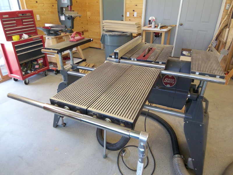

Greetings woodworkers,
While I've owned my Shopsmith for years (it sat mostly unused) I'm new to the table saw mode so please bear with me. I used this handy setup to crosscut some long stock down to rough size. It utilizes 2 fixed extension tables. I like having the second fixed extension. The rip fence and crosscut sled make for safe, easy and accurate cutting. Also note the elevated height of the extension table on your right to match the sled height. The table is nearly 7 feet long.

I like your setup but I see something in the photo that would be of concern to me. It appears that you have the cross cut sled and the rip fence in contact with the work piece simultaneously.
There might be a relief spacer between the rip fence and the work piece; I can't see for certain. I hope so.
No doubt though, the Shopsmith is great for doing this sort of work. I especially like the cutoff sled for longer pieces.

[quote="dusty"]There might be a relief spacer between the rip fence and the work piece]
You are correct Dusty there is no relief spacer and there should be. I must admit I never use one, especially working with MDF as much as I do. The saw powers through it with ease and never a kickback. But I think I'll make a spacer anyway just to establish "safe working practices" like Francis said in another post. You never know when things can go wrong.

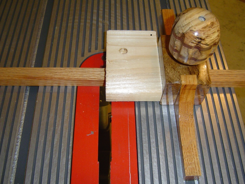

I clamp the spacer to the fence then measure to the spacer. After I have the fence distance placed with the spacer, I'll slide the spacer to the front of the fence (closest to me) before I start the cut.
I made this table saw gauge a couple of months ago that makes measuring the distance to the fence a lot easier now too.
[ATTACH]12572[/ATTACH]
The gauge sets in the miter slot, the knob locks the adjustable bar, and I use the block that sets on the adjustable bar to set the blade to a 'zero' position. Then I'll slide the fence with the spacer clamped to it to touch the end of the bar and I have my cut set up.

dasgud,
I must be a little slower than others here, as I'm not following how the jig is used to measure distance to the fence. Maybe because the whole "use a spacer against the rip fence" is a new concept to me. It sure is pretty. Just not sure how it is used.
So... what is it about a rip cut that makes it safe to run along the fence that isn't safe for a cross cut? Is it because it is the wood against the fence is the portion that gets fed into the saw blade (as opposed to feeding the wood into the blade by pushing on the side that is not against the fence? But how is that different than feeding a cross cut into the blade by pushing the wood that is between the fence and the blade?
