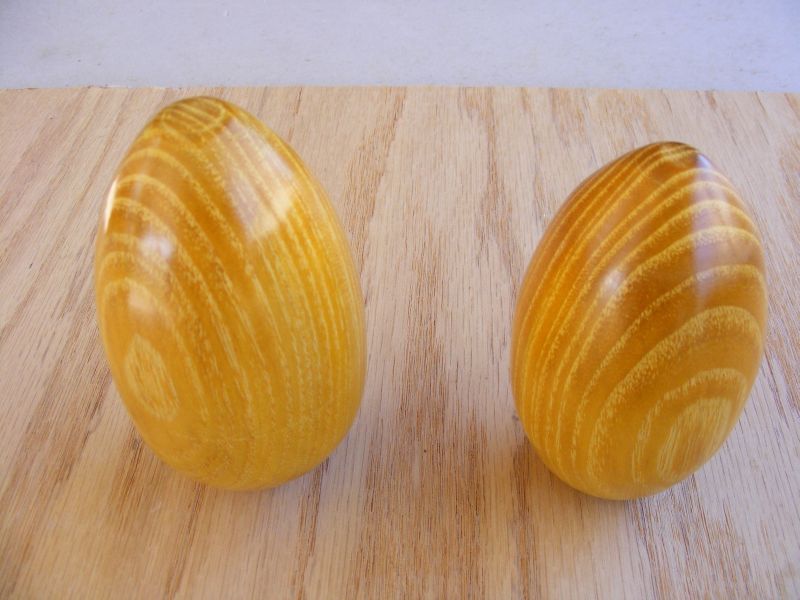

Dusty once you get into turning you will be hooked, then you will be doing pens and small bowls and vases. Just let us see what you are learning on and then we can trade care packages of wood to share for pen and small vases. I have several of the group I trade wood with from time to time. Have fun.
- Osage Orange Egg small.jpg (76.65 KiB) Viewed 2998 times

You might be able to stand those eggs on their small end!
