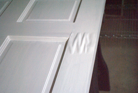

I was helping my brother in law install a "new" interior door this weekend. We picked up an unused, unfinished door and were down in the basement priming it for paint when we noticed what appears to be the veneer lifting off the door in one spot.
Anyone have suggestions on how we can get this glued back down?

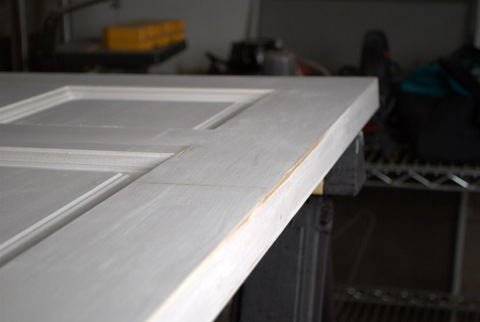

Try this...[ATTACH]13196[/ATTACH]
and this...[ATTACH]13197[/ATTACH]

Primer is????
I would not try anything until it has dried. It MAY flatten back a little. I fear you will have to get glue under it and apply pressure.
Consider returning it to where you got it. Methinks it is 'defective'!

If for some reason you can't return the door, you'll need to get glue in there. One way is to use an hobby/xacto knife to cut slits in the veneer with the grain of the wood so that you can insert glue under the veneer. For glue, I'd use Titebond III, waterproof glue and insert it with one of those bellows-type glue injector bottles. After inserting the glue, cover it with wax paper and then a square of plywood or solid wood and clamp it in place until the glue dries.
Even though repairing isn't that difficult, I'd send it back. There could be other problems with the original glue job that could show up later.

Return that door if posable, it's defective. I worked in a door factory for 10 years and de-lamination is from poor adhesion and/or moisture getting under the veneer, it will only get worse. You can try to re-glue it but it will not lay back down right.

Thanks guys. It is as I feared - most likely a defective door.
The primer was only Kilz indoor/outdoor water based primer and stuck well every where but this one spot. We'll probably try to glue it back down just to get the project finished, but I wouldn't be surprised if a "new" door is in his future.

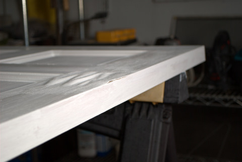

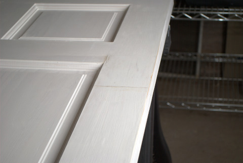

Returning the door wasn't an option for us. So, here are photos of the repair:
[ATTACH]13208[/ATTACH]
[ATTACH]13207[/ATTACH]
We ended up cutting across the grain, lifting up a flap of veneer, and smearing glue underneath. The veneer didn't fit exactly back in place, so a little trimming was needed. But, with glue filling the cut/gap and the door painted, it looks good.

I hate those kinda doors. They are everywhere these days,too! Any moisture at all and "BAM"==== huge delaminations. You did a decent job repairing it. You must have the same luck as me! "Not an option" is so familiar to me!!! Good job, though! jimsjinx
