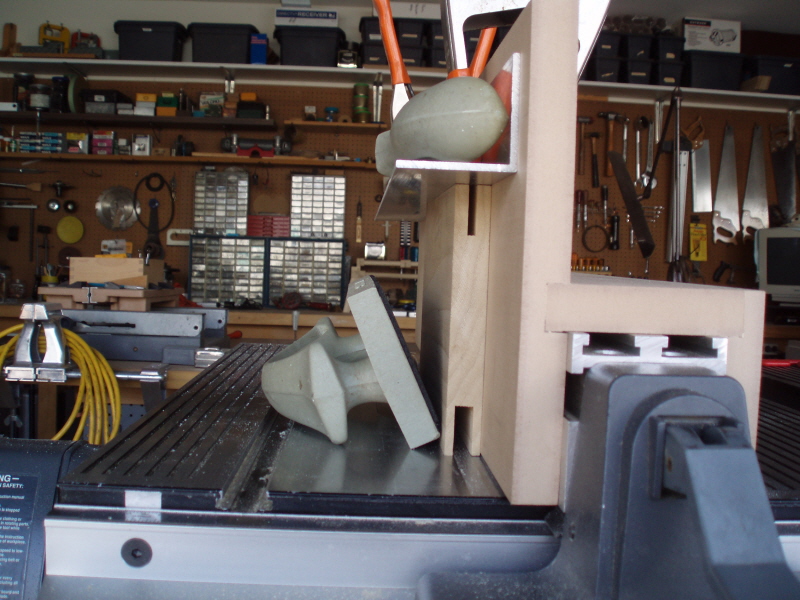

ProFence High Back Jig
This is not really a solution to your problem but it may give you some ideas.
I use this a lot for tasks such as those depicted in the picture but I also use it for surface sanding pieces as much as 3" wide stock (maybe a little more) using the conical disk.
[ATTACH]13612[/ATTACH]
BTW 3/4" MDF is definitely over kill for this jig. With some proper bracing this could be made with 1/2" material and be much lighter in weight.
This particular fixture hugs the rip fence so firmly that I don't need to use t-nuts to secure it to the fence.

Yup. The stock is nearly as thick as the rip fence is high. Good news is that I ran down to the basement where my wood shop is and tried the paper wedge trick. It worked no problem.dusty wrote: If you simply used clamps to attach the sacrificial fence (with wedge) to the rip fence, would the clamps get in the way of what you are sanding?
That does look like something I should definitely build. I built a similar for my stand alone table saw when I was making a raised panel cutting jig. The link is on another woodworking site, here. http://lumberjocks.com/projects/38569.dusty wrote:This is not really a solution to your problem but it may give you some ideas.
