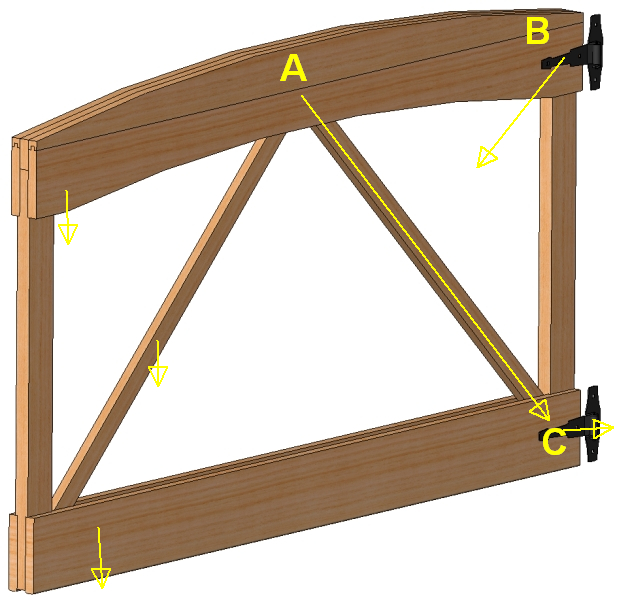

The forces on the gate are illustrated below. Only points A,B,C are of concern. The rest is merely resisting gravity.
A is being compressed down toward point C along the diagonal brace which will be in compression. B is being pulled down and left(rotation) by the most of the weight of the gate. C is being pushed right and slightly down.
The 'brace' on the left is essentially decoration. The left joints are minimally loaded(provide gravity resistance only).
The most critical joints are A and B.
A blind dowel at A would be good. The hinge would cover exposed dowels at B and C. Larger diameter the better(up to the point of weakening that which is being 'doweled').

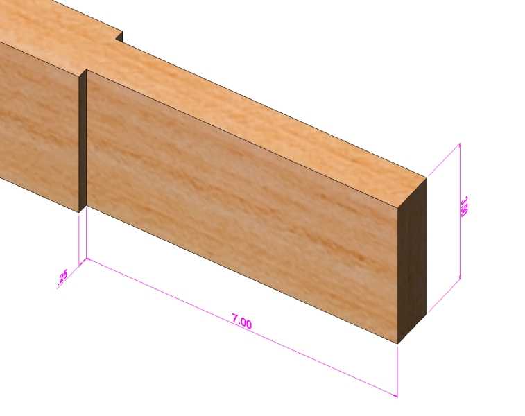

I wonder how to make the deep tenons in the ends of the edge boards. I was planning on using the tabel saw in cross-cut mode to cut the shoulder of the tenon, and then 'mill' the cheeks using router. I guess the dado in cross-cut mode would be another method. I don't see how the Tenon Master Jig could be used.
By the way, the edge boards 2x4 cedar and are 40 in. long.

onetrack wrote:I wonder how to make the deep tenons in the ends of the edge boards. I was planning on using the table saw in cross-cut mode to cut the shoulder of the tenon, and then 'mill' the cheeks using router. I guess the dado in cross-cut mode would be another method. I don't see how the Tenon Master Jig could be used.
onetrack
To make the longer tenons, I would use a dado blade and the cross cut mode. I would have a long support extension on the miter gauge. I would use the rip fence as a stop for the tenon shoulders. Mill with a router? - no need! If the tenons need touched up use a hand chisel.
Kind of like making a half lap joint but with a shallower depth of cut.

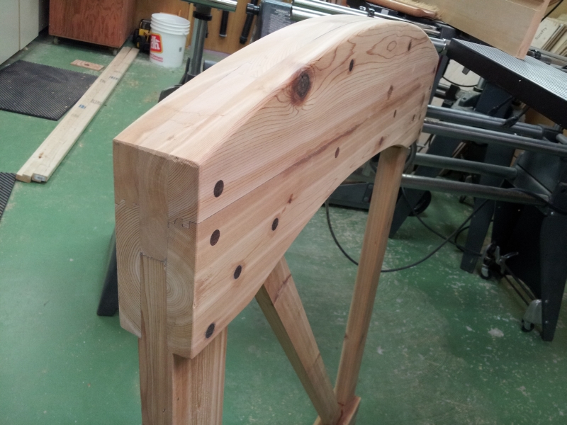

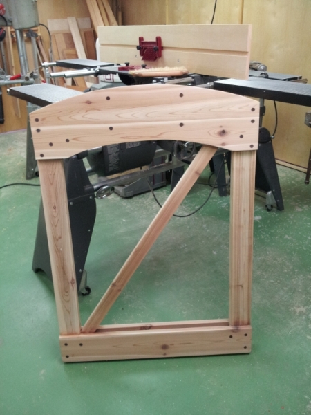

Finally made one!
Thought you might appreciate an update on this project. I found a bit of time to putter away at this... finally finished the first small gate. Made from lumber-yard cedar decking boards, expoxy, maple dowels. I stuck to the design very closely.

That's too purty to put outside!:D
What did you use for dowels?
Finish? Paint?:eek:
Finish? Paint?:eek:
Dowels are heat treated Maple http://www.finewoodworking.com/tool-gui ... rough.aspx
