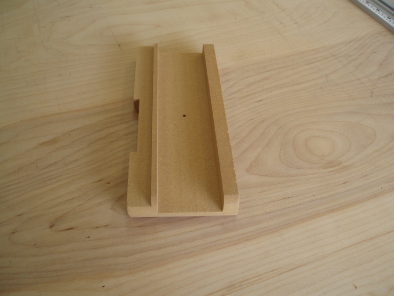

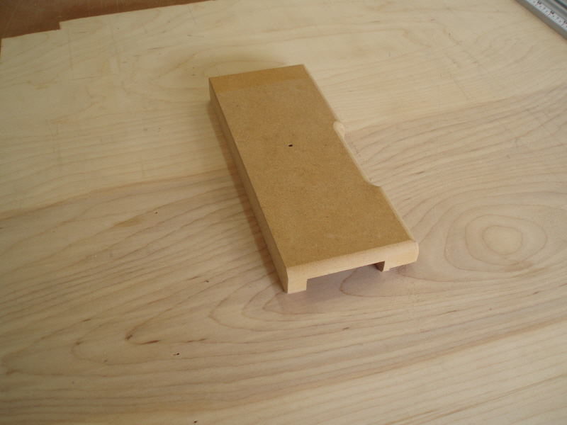

don't throw it in the trash! Make something.
[ATTACH]13961[/ATTACH]
[ATTACH]13962[/ATTACH]
[ATTACH]13963[/ATTACH]
[ATTACH]13964[/ATTACH]
- P8100002.JPG (189.15 KiB) Viewed 2597 times
- P8100003.JPG (182.9 KiB) Viewed 2592 times
- P8100004.JPG (195.42 KiB) Viewed 2591 times
- P8100005.JPG (188.34 KiB) Viewed 2597 times

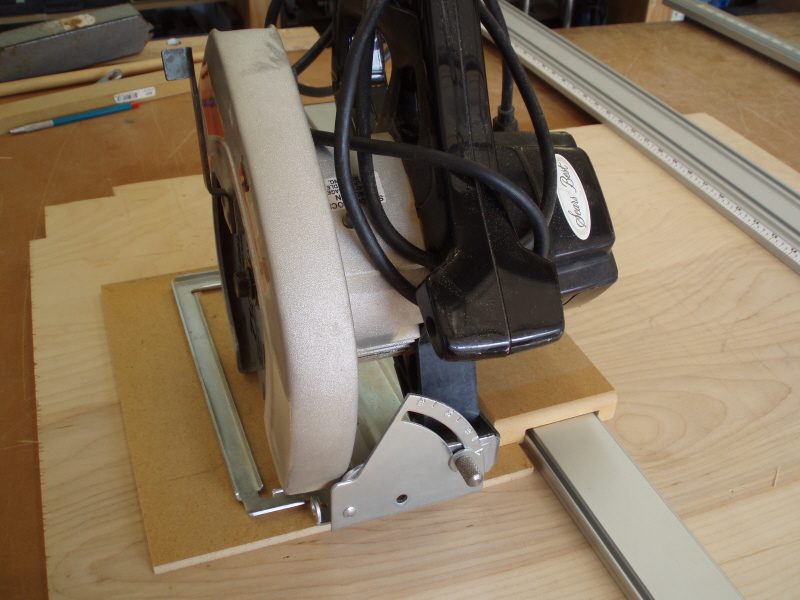

a couple more images but it's not done yet. Still have to drill for the saw hold downs and glue it all together.

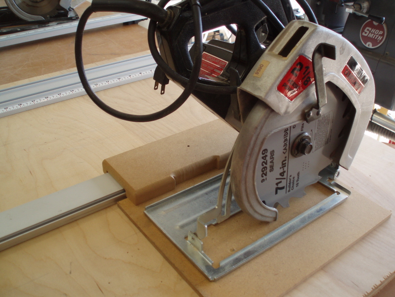

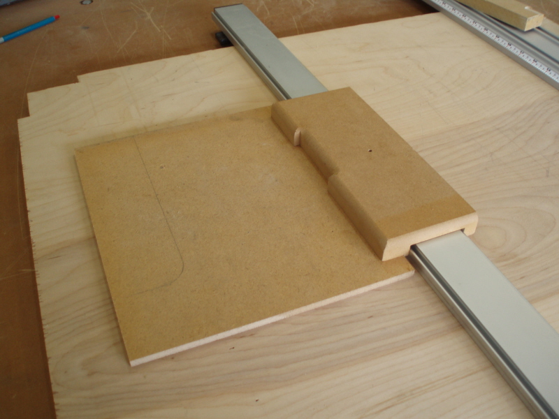

[attach]13968[/attach]
[attach]13969[/attach]
[attach]13970[/attach]

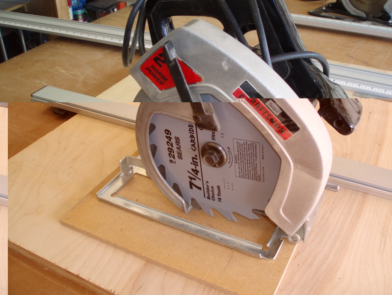

It feels like it is going to slide smoother than the one I bought.
I am debating about the cut out. I just might make the base into a ZCI but that would disable the saw guard. Don't know yet.
Ahhh. Might not be able to remove the blade without dismounting the saw if there is no cut out.

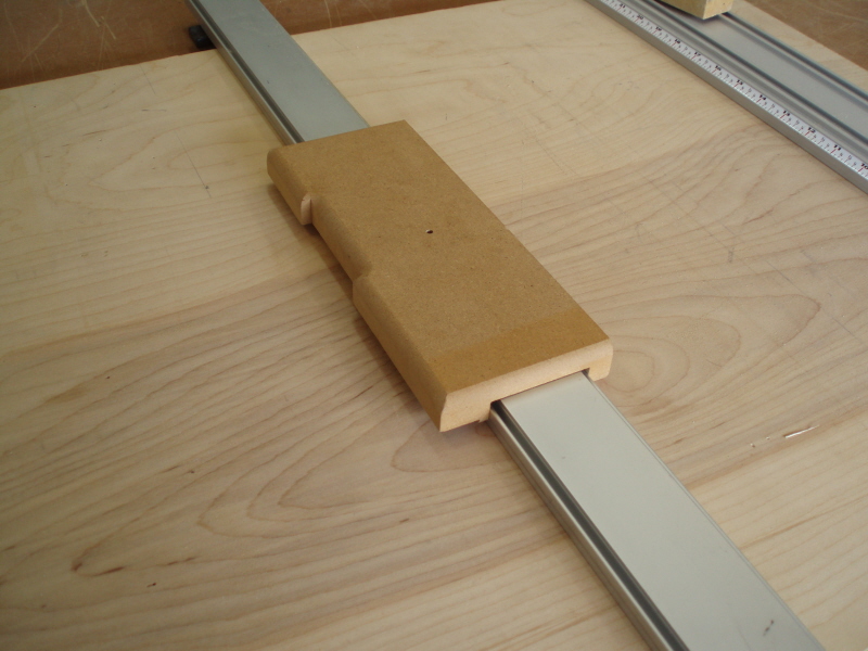

- P8100006.JPG (240.34 KiB) Viewed 2589 times
- P8100007.JPG (255.59 KiB) Viewed 2592 times
- P8100008.JPG (248.27 KiB) Viewed 2588 times

Actually the front part of the blade is what is cutting and the rear is where the saw guard is at. With very careful cutting you can in effect have both
ZCI and useable saw guard. Just cut enough of the rear opening to allow the Sawguard to swing down and leave enough on either side of the blade to have a ZCI in the front of the plate. Check Ez guide they use a separate insert but I think with judicious cutting you can accomplish nearly the same thing.

Two reasons
First with just the plate against the clamp you can always veer off the non clamp side. This could ruin waste side if you were say cutting sheet stock for multiple panels. With this method the blade is locked against the fence and can't veer to either side.
Second many circular saw plates aren't parallel with the blade. Using a plate you can make the blade and side of the plate perfectly parallel.
Ed in Tampa
Stay out of trouble!
I think the theory is that if you can secure the saw to the track you will get more accurate cuts because the saw won't have any chance to drift away from the cut line. There may also be an advantage if he's successful in rigging up a ZCI that doesn't interfere with the blade guard.farley wrote:Am I missing something?
why don't you just use the saw guide base to ride against the clamp?
EDIT: Obviously, the previous poster beat me to the first point....
If you were able to evaluate some of the cuts that I have made with just a straight edge clamped to the work - you would know. I have done it that way for many years and would still be doing that if the EZ thread had not come along.farley wrote:ok, I do see the points, thanks guys
I am cheap. When I realized some of the advantages and that I had three or four straight edges that could be used I wasn't about to buy a saw plate for each of them. I would not have the one I have but for the fact that I got it on clearance sale.
Any straight edge would work for this. Just tailor the saddle to the straight edge.
