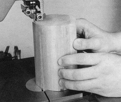

Now I don't know if you have a bandsaw but that can be helpful in getting the raw stock more "round" then a square, hex, or octagon.
[ATTACH]14060[/ATTACH]
The limit would be the height, you have about 6" to start with so the bowl has to be less then that. The width can exceed the diameter that the lathe can turn so that is not an issue.
