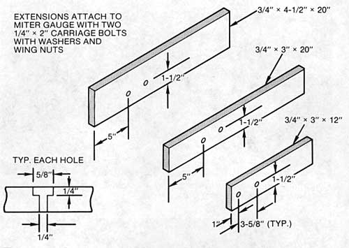

First we need a plan so we can find the dimensions to build one of these. It just happens shopsmith provides one:

The length in the drawing shows up as variable but the one shopsmith sells it is 12". So I had two blanks that were 1-1/8" thick by 3" tall by 12" long. Again I will defer the larger one for the bandsaw to a point later.

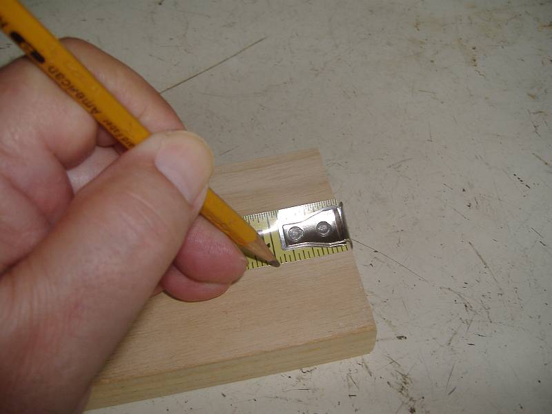

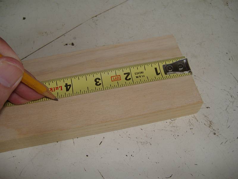

A common tool for this sort of measuring is the tape measure, again measuring out the first inch and marking.
[ATTACH]14087[/ATTACH]
The second mark again would be at 4-5/8" despite me showing more like 4-1/2"... can't say I haven't done something dumb like mis-measuring but in this case I was looking through the camera and it looked closer then it was...
[ATTACH]14088[/ATTACH]

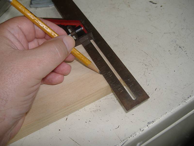

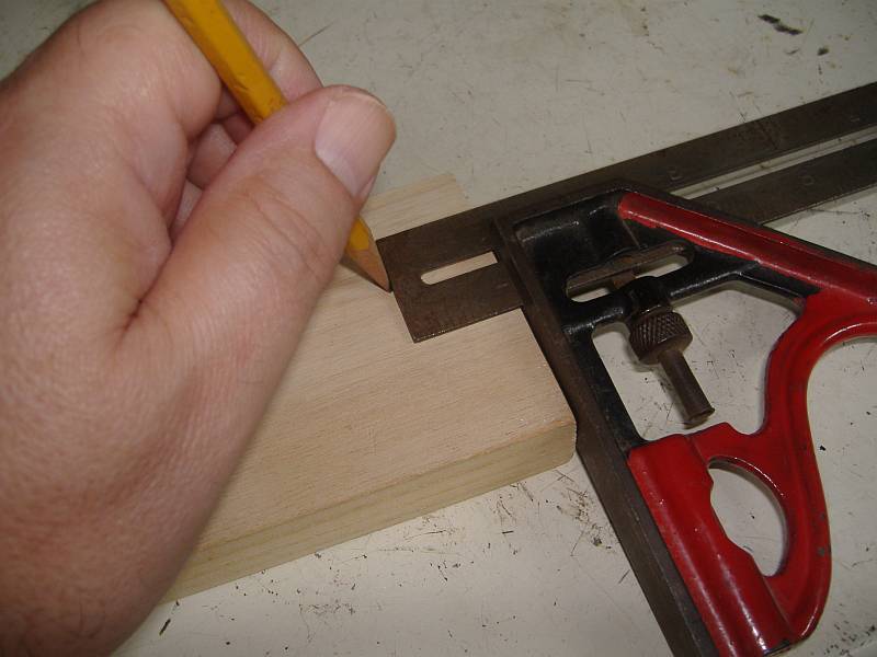

From the marks you need to make lines and it is best if they are square, any square will do so long as it close for this project.

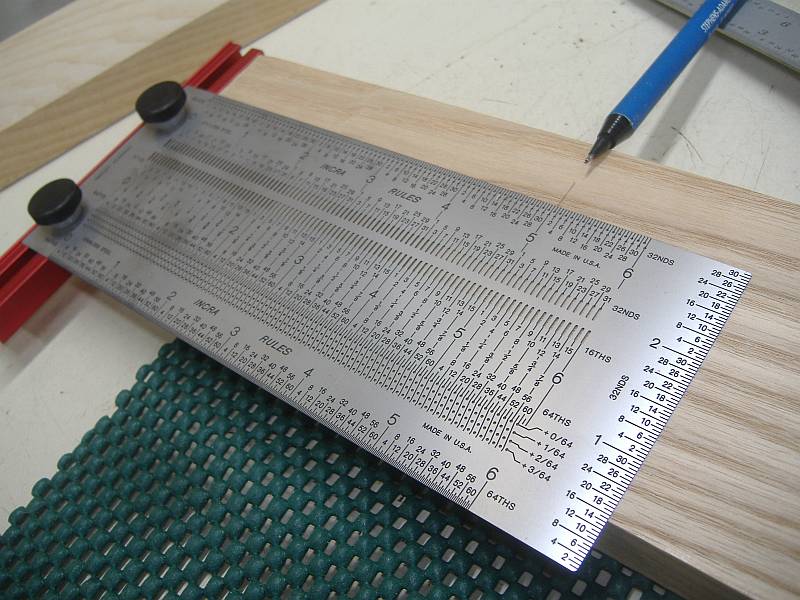

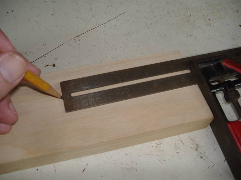

I'm sure you may have an old plastic school ruler that has sat in a drawer since 1976 but you might want to upgrade to something a little more fancy for your woodworking. What is pictured next is what is commonly called hook ruler. The little hook on the end does the function of the clip on the tape measure or head on the square.
[ATTACH]14089[/ATTACH]
Yes you can just use your finger and stick the ruler up against it and measure away, tempting no doubt but if you want to do it that way you might not want to go on to the next part of this post.
Yes we are getting to the topic of the INCRA T-rule that I mini reviewed here:
https://forum.shopsmith.com/viewtopic.php?t=8659
You have been warned. Don't go any further if you are offended by such tools. Final warning, a precision tool is going to be shown and used coming up next.

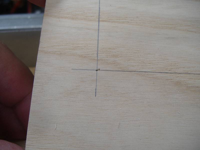

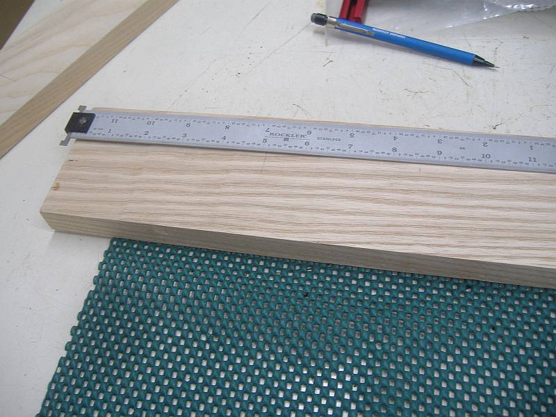

Still with me? Look now you have me asking questions...

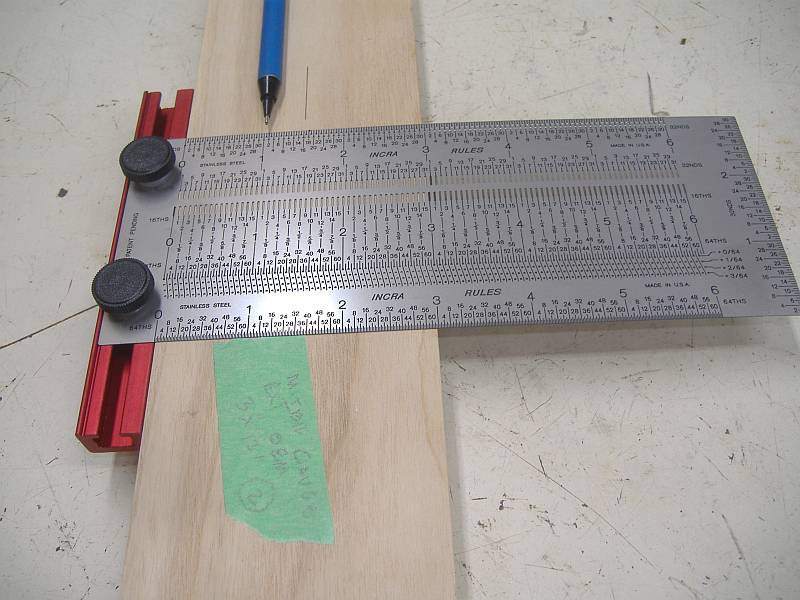

This first shot show me testing the .5mm pencil and making a line. Firth thing that came up was the fact I need a hand to hold the pencil and one to hold the t-rule and another to hold the work piece. Yea that can't be done without a little help. So who wants to know the shop-tip of how to solve this problem? We will get to that in a moment after you take a look at this picture.
[ATTACH]14090[/ATTACH]

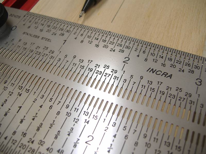

Maybe this close up will help you see how this product works.
[ATTACH]14091[/ATTACH]
Still waiting on the shop-tip right? OK, check the next picture where you see the green shelf liner that provides the extra hand to hold the work piece in place while you mark it up.
[ATTACH]14093[/ATTACH]
From here will will go to the drill press, yes the holes are coming up real soon now.

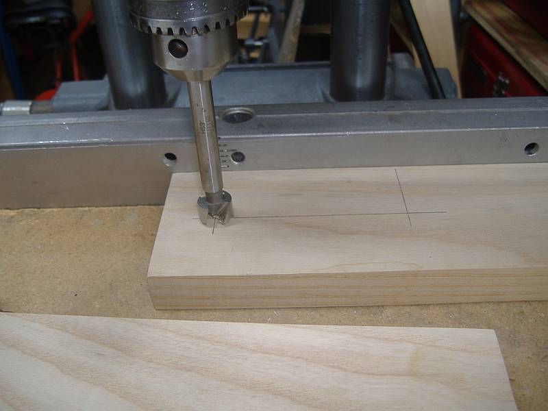

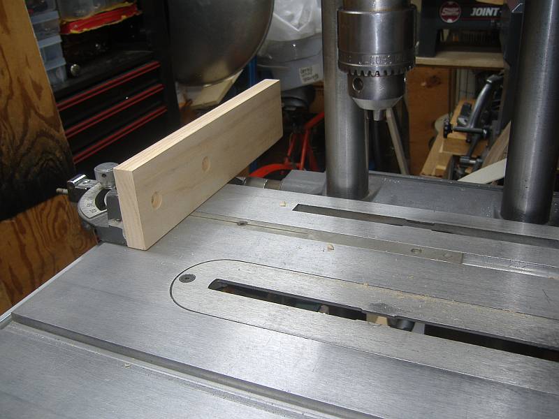

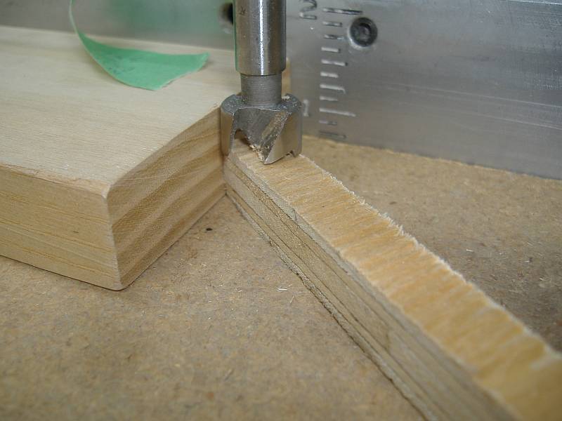

As a general point, you want to have a sacrificial top cover for your main table, shown in the next picture. You can use the area where the table insert is or the more open area if you remove the table insert but as the bit exits the work piece you are very likely to get tear out, while have the sacrificial is more like to give you clean holes.
It is also nice to use the rip fence as a guide. The holes are 1-1/2" up so if the fence is set to give you a hole that is 1-1/2" away you can then just worry about getting the location of the hole on just one axes. Just in case make sure you mark which side of the work pieces was against the fence so we can use that to our advantage when we drill the through hole.
This is a good time to bring up the fact that the work piece should be 3" tall and if it is perfect then it will not matter which side goes against the fence, right? Maybe, you have two factors working against you. First you may not be right on the 3" height and second your measurement of 1-1/2" from the fence might not be right on... either or both off and you will not get as good a result as if you just keep the same side against the fence... remember I told you so if it goes wrong. This project is forgiving but again we are using this for practice, some other projects will not be that forgiving.
In this case I have adjusted the fence to what looks like about 1-1/2" and mounted a 5/8" Forstner bit.
[ATTACH]14094[/ATTACH]

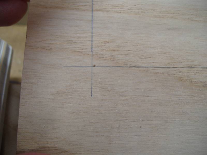

Now keeping in mind the fence is controlling that 1-1/2" dimension and you are controlling the cross direction it is a good idea to do a "touch". This means bringing the drill bit into contact with the workpiece and leave a small mark. You should be able to see it in this photo.
[ATTACH]14095[/ATTACH]
Pretty close and this might even work for this project but you can do better. A small adjustment and look where the touch is now, that looks good to me.
[ATTACH]14096[/ATTACH]

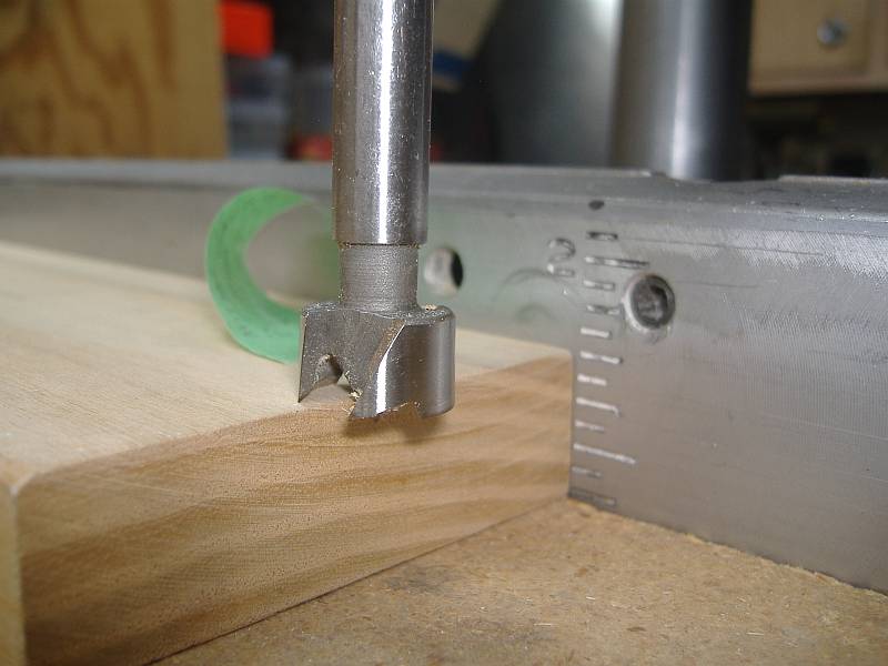

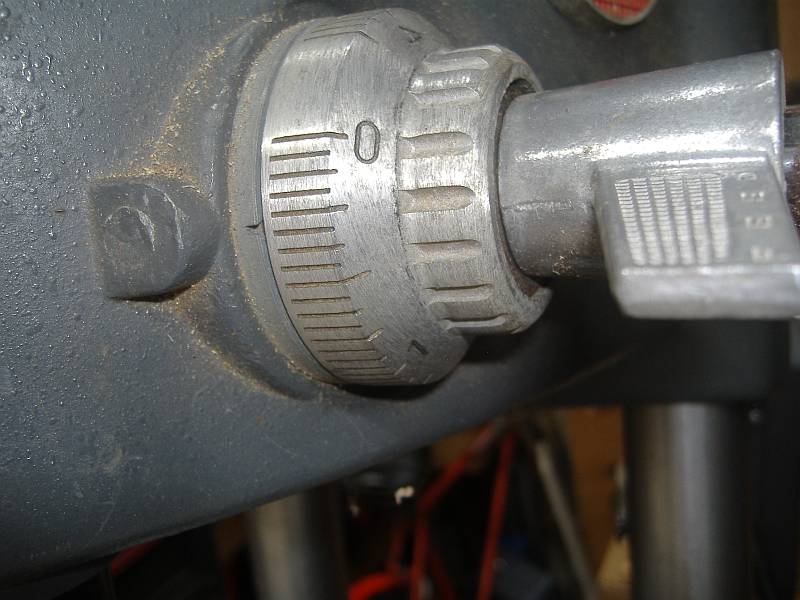

Now on to setting the depth. One way is to bring the bit down to the surface of the workpiece then set the depth gauge on the shopsmith. Simple and effective and pictured below.
[ATTACH]14097[/ATTACH]
[ATTACH]14098[/ATTACH]
It is always good to do a visual check, here you see the bit is going to be cutting deeper then it needs to. Yes it would still work but then remember once again we are trying to use this to improve our skill.
[ATTACH]14099[/ATTACH]

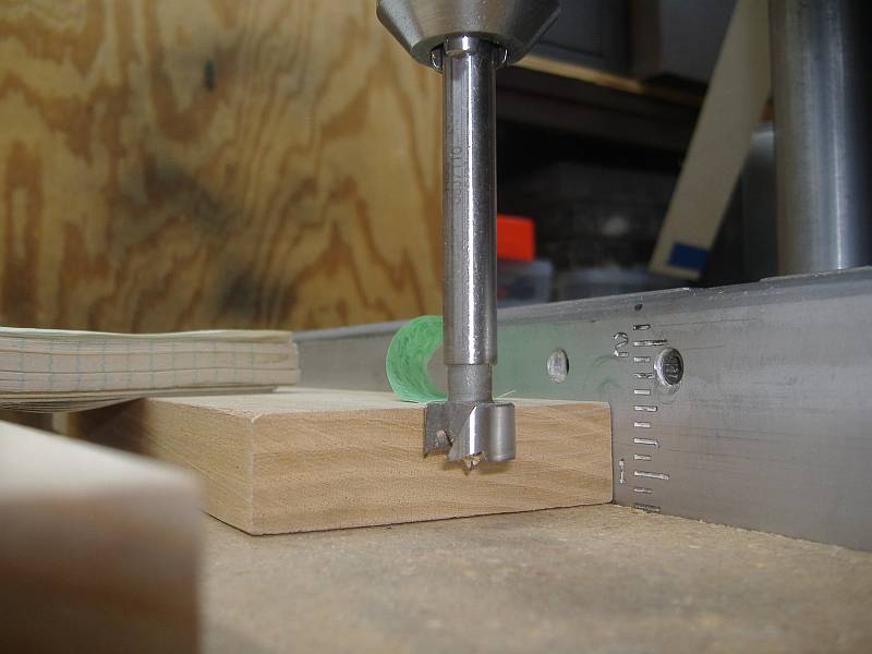

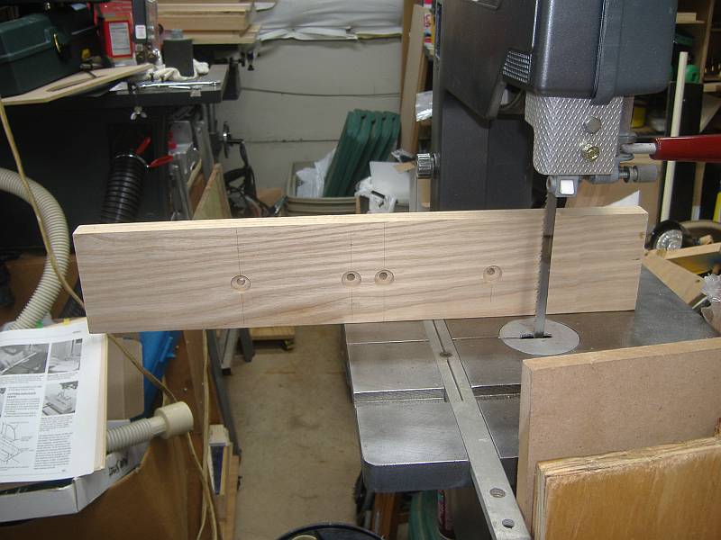

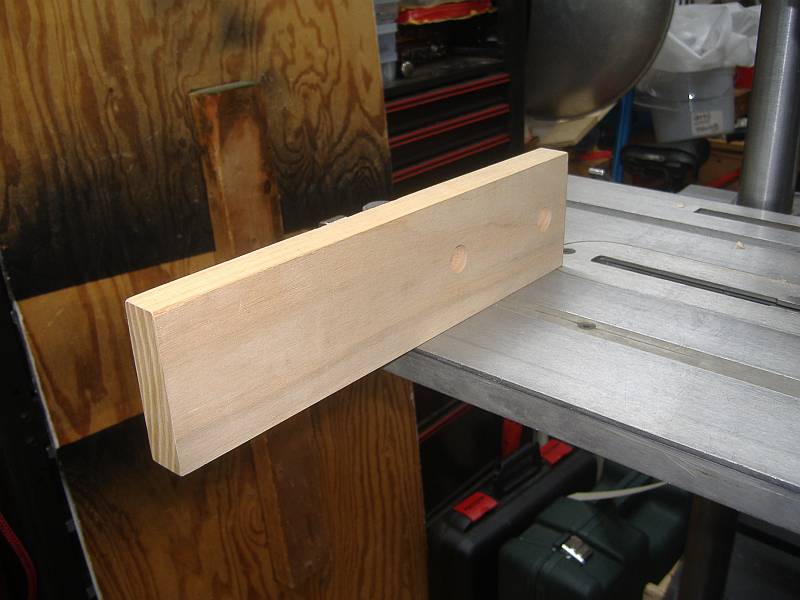

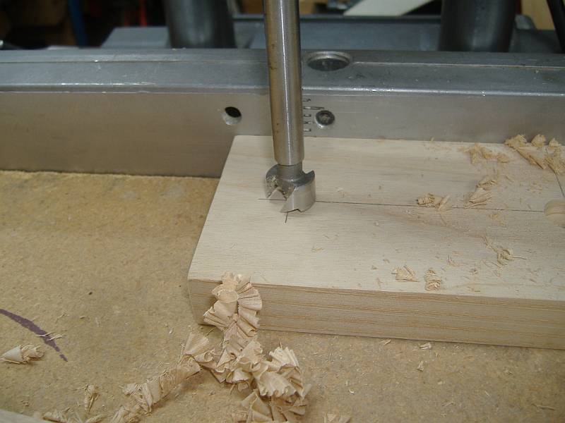

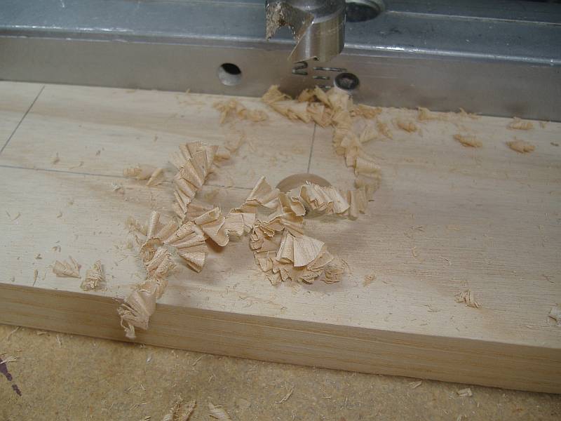

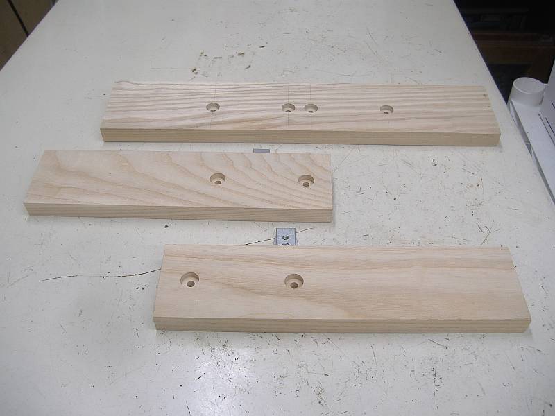

The next operation is to really drill the holes. But we have not talked about what speed we have selected. I have a chart I keep handy but in this case I just turned it down to slow (700 rpm). You will get to the point that some of this becomes second nature but until then get a chart to have in the shop.
One other pointer, on smaller Forstner bits you need to raise the bit to clear the shavings, this also helps prevent to much heat build up. Since this hole is only 1/4" deep and the bit size of 5/8" you can do a continues feed without things heating up too much. (BTW the cart says the bit should be running at 500 rpm.)

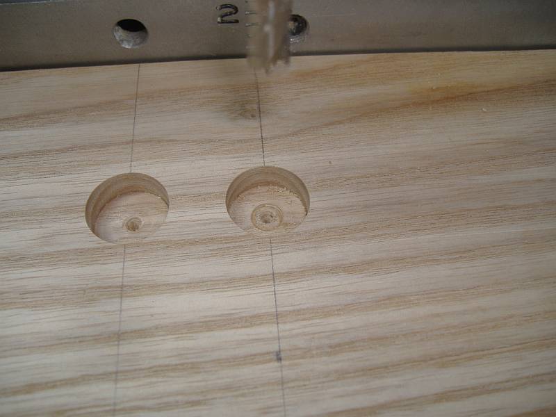

Let's look at the first hole.
[ATTACH]14101[/ATTACH]
Second hole same as the first...
[ATTACH]14102[/ATTACH]

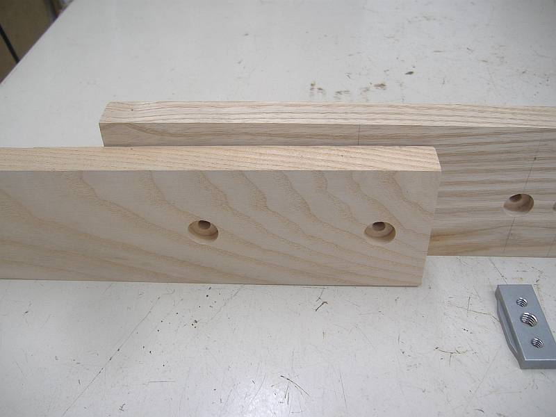

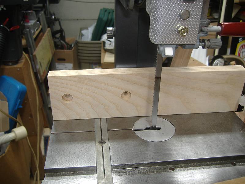

If you are making more then one you will want to drill them all now. Make sure you do not get wood chips behind (fence side) or under the workpiece, they can change the position of the work piece and cause you to drill the holes in the wrong places. A shop brush can be useful in getting all the chips out of the way or there is always the shop vac.
At this point with all the countersunk holes drilled it is time to do the through holes. For me this was in the form of removing the 5/8" bit and then installing a 1/4" brad point bit. You could use a standard twist drill here, just might not get as clean a hole.
If you don't have any Forstner bits in your collection I think about adding them really soon. Even a set of 4 goes a long way towards upgrading what you can do in the shop. Same with the brad bits, once you start drilling the cleaner holes you will more then likely want a whole set.
Do not move the fence. We will use the fence again and it will make sure the holes are still at the 1-1/2" up from the bottom. Again make sure the same side of the material is against the fence (see previous postings for details as to why you need to do this).
Make sure you reset the depth control so the bit goes though the material, and kick the rpm up to "D" or so.
If you happen to be using the brad point drill you can "feel" the hole left by the previous drilling operation and that will be right on. If you are unsure do a touch and see where the hole is going to be. You want it right on the center of the previous operation. In this photo you can see what I mean.
[ATTACH]14103[/ATTACH]
By now you should have the basics of how the drilling part of this project is done. We are next going to talk about the bandsaw model, yes I know I've been putting you off on that for several posts... and it is happening again as we will cover that in the next posting.

This is what the bandsaw versions plans look like:
[ATTACH]14104[/ATTACH]
You can check out the PTWFE section on bandsaws here:
http://www.shopsmith.com/academy/bandsaw/index.htm
As you can see one version is the same as what we were building anyway. The other two are slightly different, one in length and the other in length and height.
Given my limited selection of oak on hand my "other version" is not one of the ones shown. I was able to get a piece that was 3-7/16" by 18" out of scrap. The size is no major factor in what we are talking about because just like the other two "standard" ones the holes are still 1-1/2" up from the bottom, the holes sizes are the same as is the hole to hole spacing.
What you need to take from this is that you can make a lot of changes as to what your version looks like and make it more useful for you. Sometimes it is what materials you have to work with as in my case working with scrap wood, or maybe you feel the need for a taller version to do some resawing on your bandsaw, again it can be fun to experiment.
I know, enough words, let's get to some pictures.
These are the three with all holes drilled and ready to go:
[ATTACH]14105[/ATTACH]

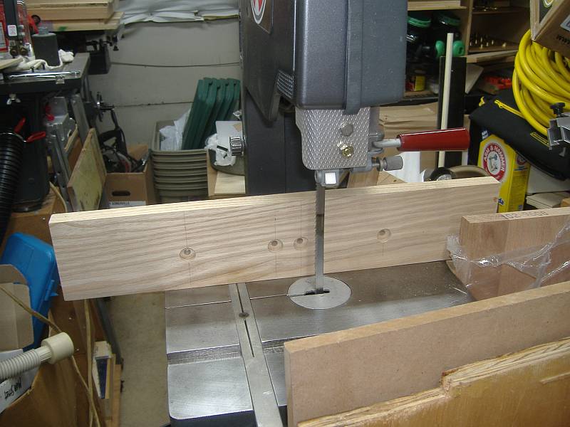

This first picture shows the extension mounted off to the right and the miter gauge in the right slot.
[ATTACH]14107[/ATTACH]
If you move the miter gauge to the left slot you can simply flip the extension over and that can be seen here:
[ATTACH]14108[/ATTACH]
Were you wanting to have more support of course you can have the longer extension towards the blade. Of course this also means your extension will have a saw cut in it when you are done. No big thing now that you know how to make more, right? A few cuts will not make much of a difference but sometime it might be chewed up enough to warrant a replacement.
Moving to the bandsaw, this is the standard version in position to be a fence.
[ATTACH]14109[/ATTACH]
Next we have a longer/higher version mounted in standard position.
[ATTACH]14110[/ATTACH]
Since a little experimentation is in order you will notice the longer fence has two sets of holes. I added these to see how I liked having a longer fence in front of the blade. It seems I might like it but I've never actually tried it so now that I have the opportunity I'm going to give it a shot. If I think of it I will report back at some point and let you know how that worked out.
[ATTACH]14111[/ATTACH]
I have one more section I want to add, have to see when I have the time to do that. In the mean time feel free to ask questions if you have them.
