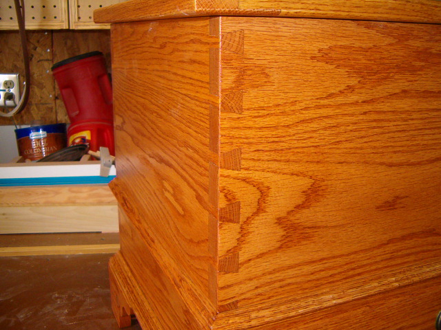

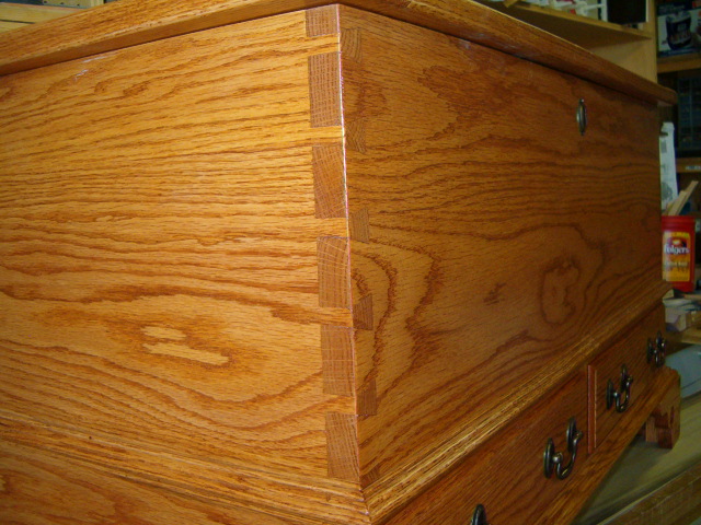

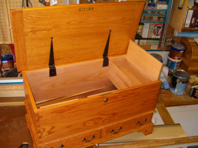

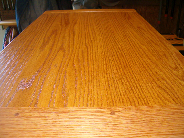

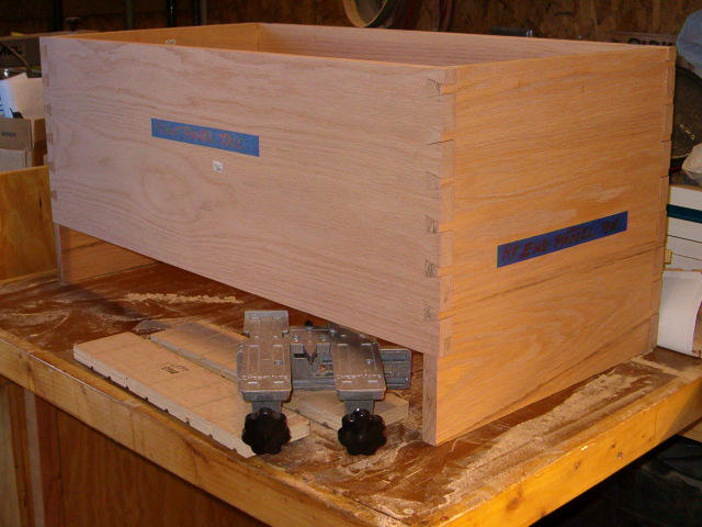

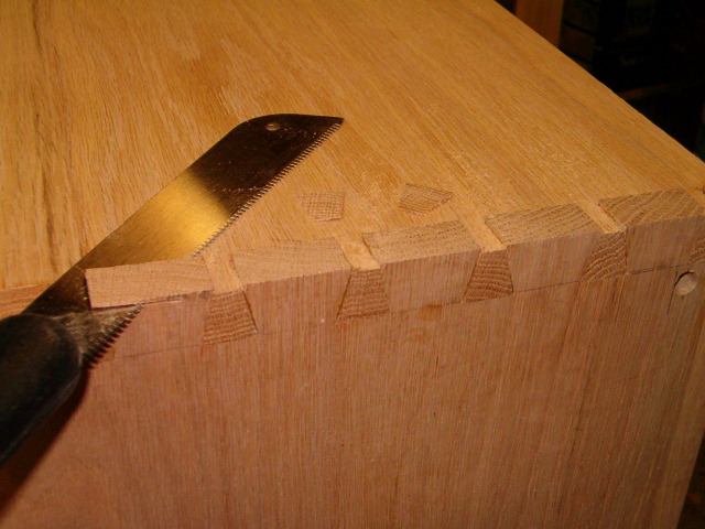

If it were to be me making this table top, I would not only rip boards to a narrower width, but also think seriously about making breadboard ends. I've made a couple of tops lately (although a lot smaller) where wider boards were ripped according to grain orientation so they appear to be wider boards on the top surface. Here's two examples: (5 photos)
The first 4 pics show matching of plain sawn grain. There are 5 boards making up the top (plus breadboards) There are only two boards on the front and sides, because the dovetails will hold back warping.
The last pic is of an unfinished coffee table top without breadboard ends. All boards are quarter swan -

charlese wrote:I've made a couple of tops lately (although a lot smaller) where wider boards were ripped according to grain orientation so they appear to be wider boards on the top surface.
Charlese can you expand upon this statement? I have some of the same grain patterns as in your first pic, on the front of the chest, just below the blue tape.
Ripping according to grain orientation
beeg wrote:Charlese can you expand upon this statement? I have some of the same grain patterns as in your first pic, on the front of the chest, just below the blue tape.
Ripping according to grain orientation:
As I see this situation - when edge jointing plain sawn boards - there are 3 major things to watch for. These are 1) surface grain, 2) color, 3) end grain
On plain sawn boards there will most probably be some rift grain. Rift grain presents straight grain on the surface and is adjacent to some figured grain (like wavy or cathedral).
It is best to rip wider boards through the rift portion of a plain sawn board, if possible. You may find it advantageous to diagonally rip a board in order to follow the rift grain. Hopefully your boards are longer than the needed 40" length in order to allow diagonal ripping.
During the ripping process, be thinking of how the narrower boards will best fit together. When finally through ripping, sort and re-sort the new boards to get the closest match of surface grain and color.
Then it's time to check the end grain for the orientation of the tree's annual growth rings. In my personal opinion, I like to keep the spacing between rings (tree's growth rate) approximately the same on mating boards. Sometimes all that's needed is to turn one board end to end.
When you get the top (surface) look as best you can grain and color), it's time to joint and glue.
I'll re-post these two pics to give you a better idea.
Both photos show the left side and front sides. After enlarging to +275 you can see the two side boards are joined right in the middle of the second pin from the top. (look at the changing annual rings in that pin) The front is joined at the third pin from the top. Although I can't see the joint in either the pin or the tail, I can see the cathedral effect of the rift grain where the boards join.

- HPIM2288.jpg (141.44 KiB) Viewed 3041 times
- HPIM2289.jpg (137.32 KiB) Viewed 3039 times
