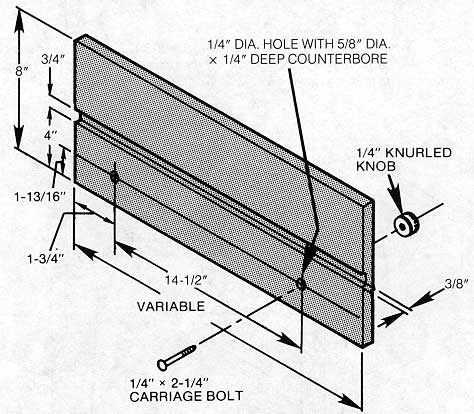

The general design provided by shopsmith looks like this:
[ATTACH]14239[/ATTACH]

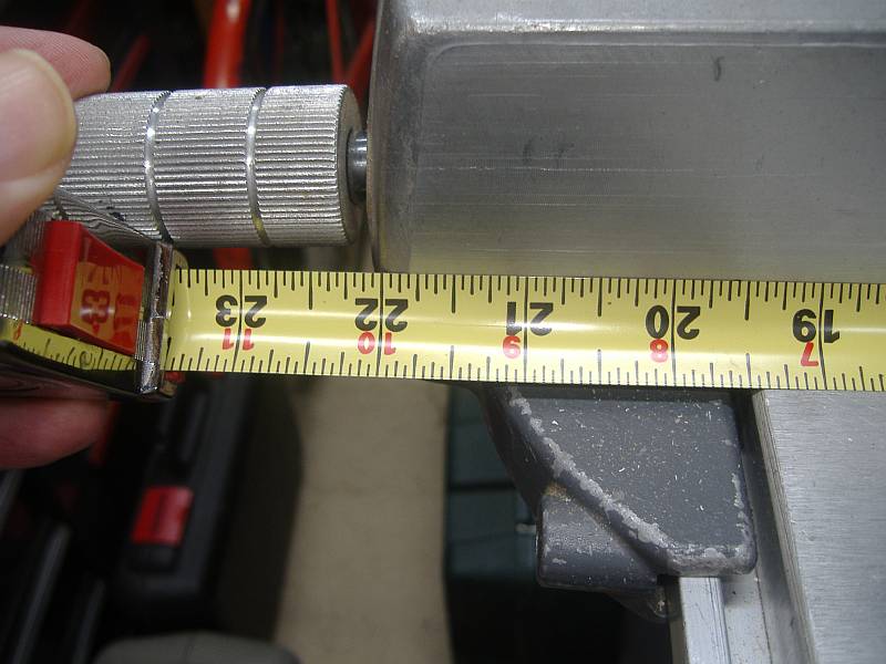

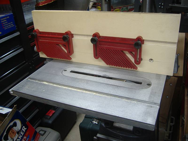

The first issue I want to address is "variable" length of the fence. I did this by a simple measurement. You could make it longer or shorter depending on how you feel about it. I would caution again making it to long where it will interfere with the tightening and loosening features of the fence.
[ATTACH]14236[/ATTACH]
As can be seen a length of 22" looks to be a good starting point. So with the length established we need to look at the location of the mounting holes. The height of the holes seems fine at 1-13/16 for a 500 fence.

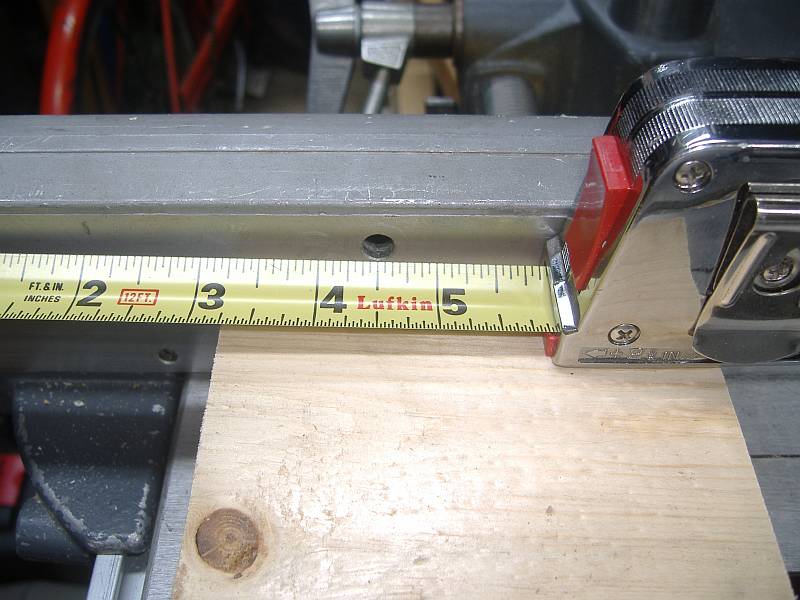

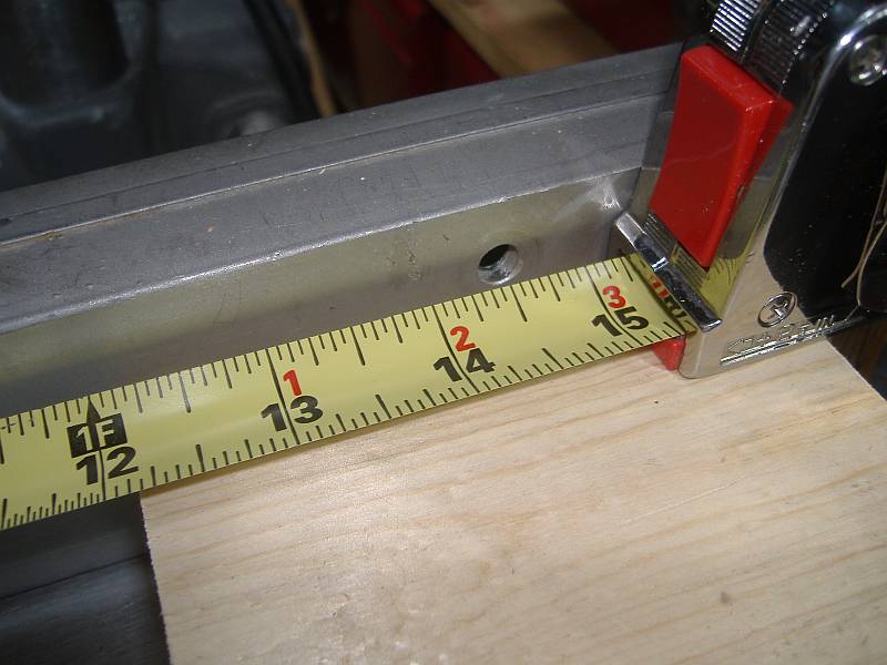

The horizontal dimension of 1-3/4" to the first hole confused me. So I went to the rip fence and took a few dimensions for myself. Based on the length of fence I planned on using the first hole looks like it should be at 4-1/2"
[ATTACH]14237[/ATTACH]
While I still had tape in hand I then checked the distance between holes. It was as shown 14-1/2", also the dimension shown in the drawing.
[ATTACH]14238[/ATTACH]
Just blind building one of these from the plan, just like any other project can be risky. In some case you just have to go by blind faith, other times you are better off taking the time to evaluate and measure to be sure. If I would have proceeded to drilling the hole at 1-3/4" as shown on the drawing the position of the fence would not have been to my liking at all.
Before we move on let's do a bit of math. First hole is going to be 4-1/2" from the edge. The second hole is then 14-1/2" from that hole, that puts the hole at about 4-1/2 + 14-1/2 = 19" along the way. That leaves about 3" until we get to the end of the work piece. Keep this in mind when we get into this next time in the next post.

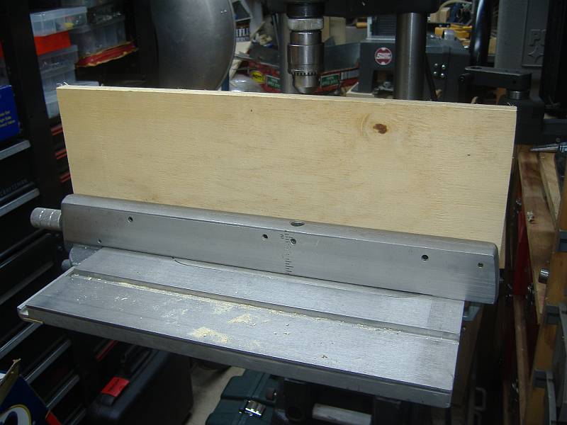

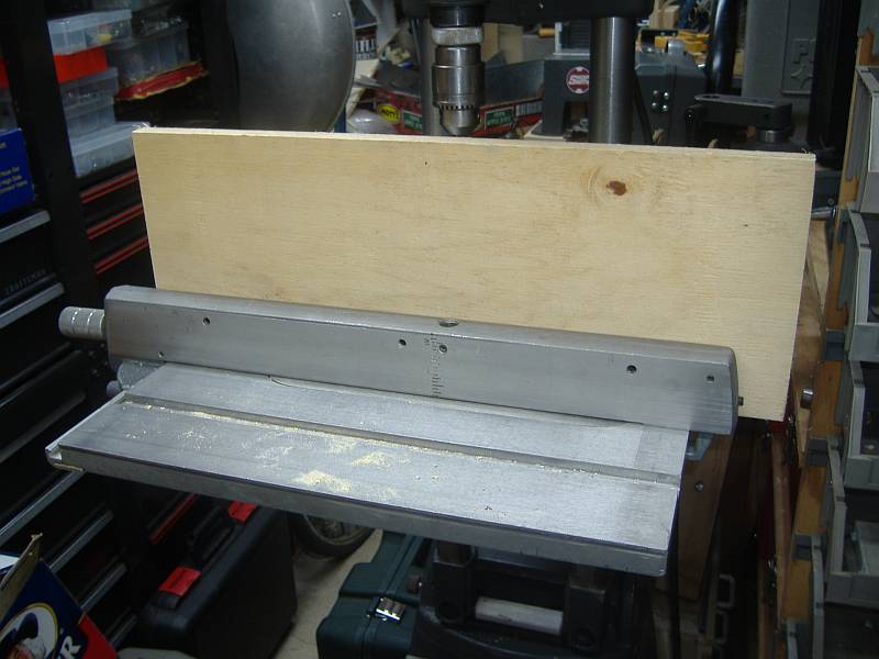

Here area a few pictures to help you sort out what I just said. The tall fence mounted to the right of the rip fence and using the holes that have it centered. (If you look at the left edge of the jig the starting hole for mounting on this side is the second one and the last one on the right).
[ATTACH]14240[/ATTACH]
If you used those same holes and mounted the fence on the other side of the rip fence (left side) then this picture would show the result.

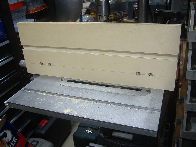

By changing to the correct set of holes will let it look like this:
[ATTACH]14242[/ATTACH]
I personally like this better but I did live with it the other way for years.

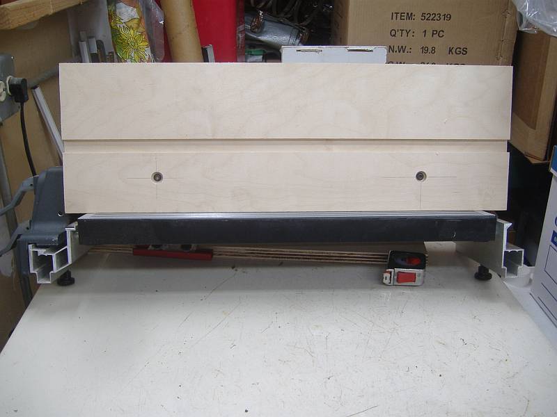

When I made my first tall fence shopsmith didn't offer featherboards so there was no reason to have a slot. Now since they are common it only makes since to take advantage of them. I did debate if I wanted to drill a series of holes for mounting or go with the miter slot. As you can see the slot won out.
[ATTACH]14243[/ATTACH]
Project finished except for some sanding and finding/buying some hardware. Of course if you have questions or have one of these that you have built feel free to ask or comment.
