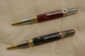

Here is a pic of a couple of high end pens that I turned using the PSI mandrel for the SS and also the mandrel saver. The parts work but I still have questions about the saver. I prefer the Power Pro to the midi lathe though.

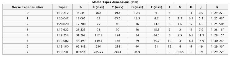

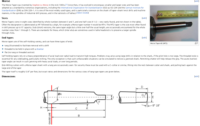

FWIW: #2 Morse Taper or MT2 or 2MT
From Wiki...
[ATTACH]14514[/ATTACH]
[ATTACH]14515[/ATTACH]

From Wiki...
A = .7 "
B = 2.95"
C = 3.15"
D = .63"
H = .197"
