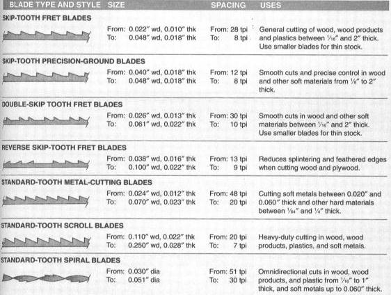

These may help -- from Woodworking Wisdom. I know the author; he won't mind.
[ATTACH]545[/ATTACH]
[ATTACH]546[/ATTACH]
With all good wishes,
