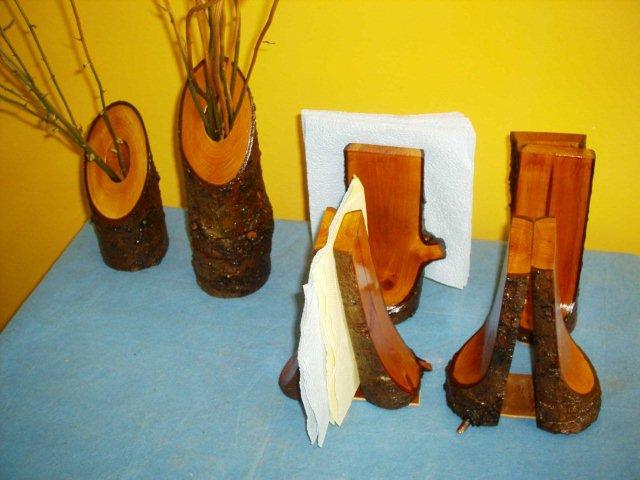

Another Tree Craft project, where the end product looks good and works well is a napkin holder. Napkin holders (right) vase (left) vase on box (middle).
[ATTACH]14678[/ATTACH]
