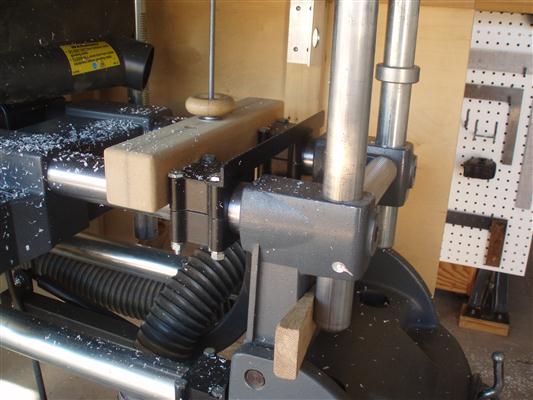

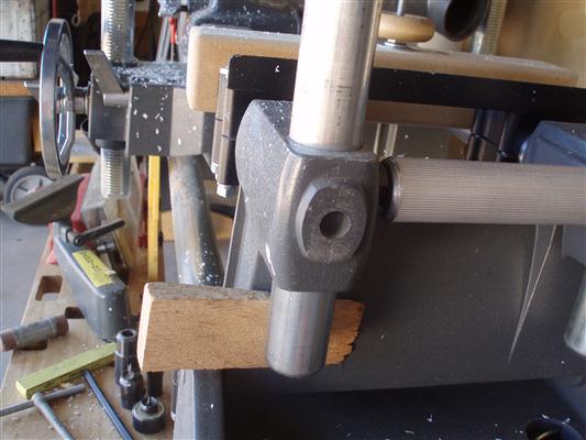

I was scoffed at for this earlier but I use a wooden wedge to stabilize the tailstock whenever I do not want 'any uncontrolled movement'. I do this everytime I set up in drill press mode too. The wedge, in the images here, is installed to stabilize the right side extension table.
[ATTACH]14853[/ATTACH] [ATTACH]14854[/ATTACH]
Stabilize Tailstock 001 (Custom).JPG (41.43 KiB) Viewed 2802 times
Stabilize Tailstock 002 (Custom).JPG (44.43 KiB) Viewed 2801 times
