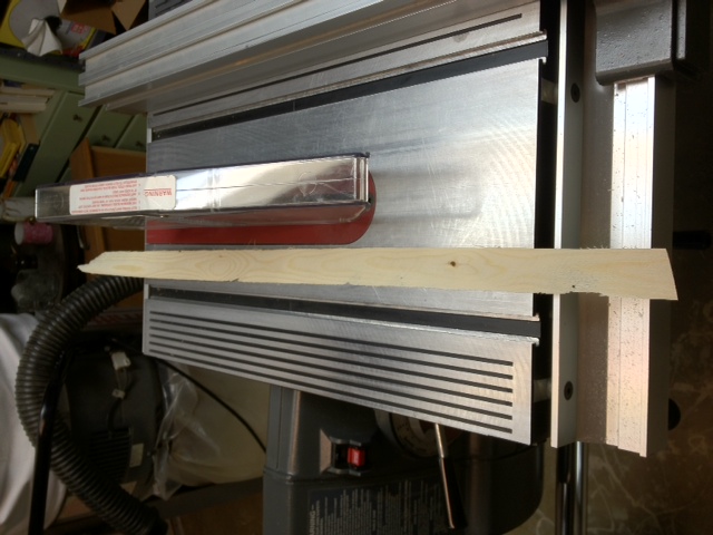

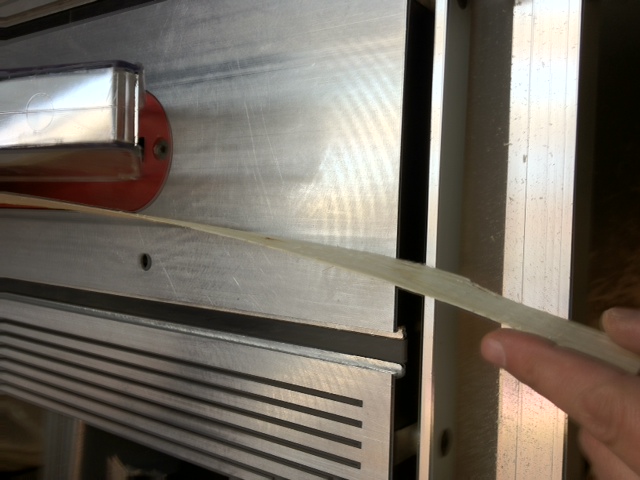

Bet you didn't know that the Shopsmith has a hidden function: the veneer saw! ;)
The 0.026 inch thick strip in the photos was actually a mistake. I had
jointed one edge and one face of a piece of 2 x 6 that I was using in a project and wanted to use my Shopsmith in table saw mode to rip the other edge parallel to the jointed edge.
The machine is a 10 year old 520, and it was fitted with a 10-year old Shopsmith combo blade that came with it from the original owner last January. I don't believe the blade has ever been sharpened and it has been treated rather roughly in the bottom of my storage box.

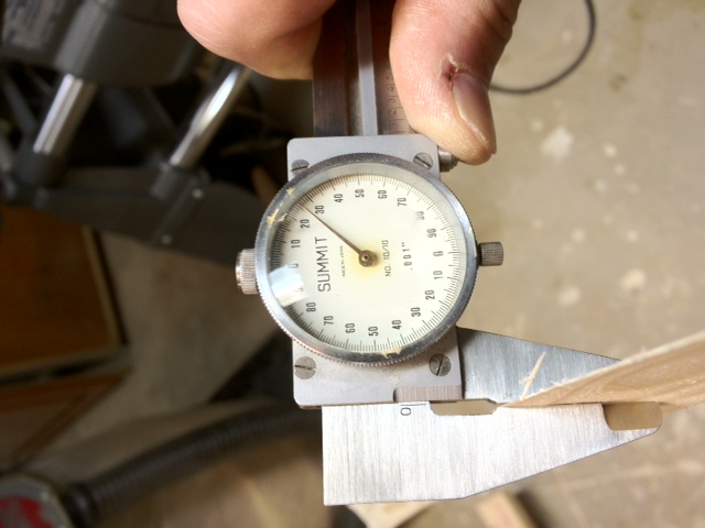

Anyway, I set the rip fence to take off just the width of the kerf from the edge, but I eye-balled the set up and misjudged things slightly. According to my caliper by 0.026 inches!
Anybody want to see if they can get a thinner veneer using their "Shopsmith Veneer Saw"?
[ATTACH]15046[/ATTACH]
[ATTACH]15047[/ATTACH]
[ATTACH]15048[/ATTACH]

Sorry to say but you are not even close to thin. A few years back I was working on making thin strips of .005". Due to issues of air flow (blade turbulence) I had to go to .007" thick. I wish I could find the details but this is as best I could do:
http://www.shopsmith.net/forums/showpos ... ostcount=4
The link to the ssug site no longer works sorry to say.
The .007" seems to be a practical limit at that time, anything less was a hit and miss operation. If I were to try it again I do believe I could get to the .005" or less by building a slotted splitter to protect the thin strip. The cutting wasn't the problem, the breaking of the thin wood was.

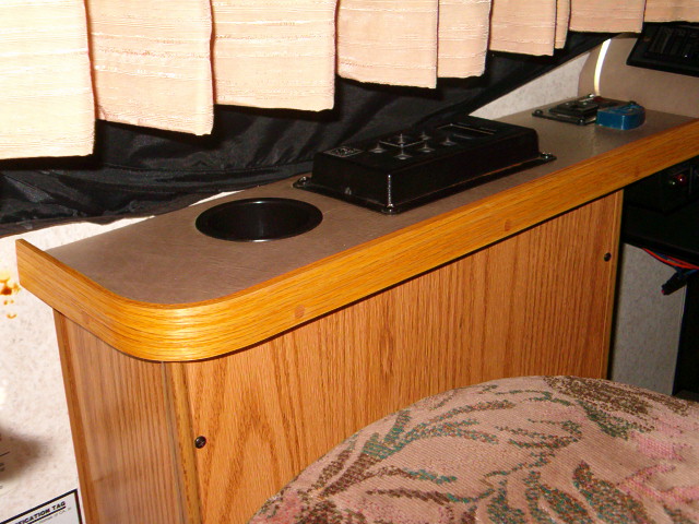

There is a bunch of uses for wood strips. They can be bent around a form and glued together (stacked) to make curved boards. Here's one project, but the strips were a bit thicker than .005". Other uses of such strips would be inlays, shims, and weaving baskets or such.
[ATTACH]15066[/ATTACH]
