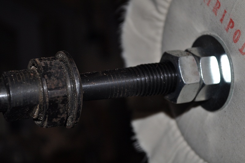

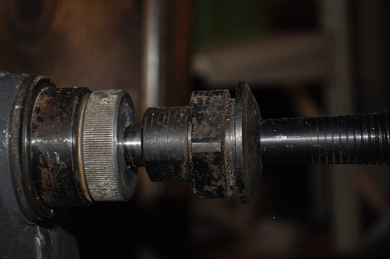

With a little thought, I have come up with my own solution.
I already purchased a 3 wheel polishing "kit" from Penn State...without reading the fine print about the DRIVE side. So I had something that, for the time being, there was no way to use it on a Shopsmith. From the time of the posting till now...well there is a solution.
I am using a 1 1/4" arbor as a substitute. The center hole is just big enough to bite into the rod and supply drive to the polishing wheels. since the polisher is not subject to lots of lateral pressure...I guess it is good to go.

Hi,
Sounds like you have something there, give us a report back after you have used it a bit and perhaps show is a picture of the setup. Always like simple solutions when you can find them.

Here are a couple of pictures. I plan to try it out tomorrow on some pens. Bdefore I do, I will put a couple of washers between the arbor body and the quill face to keep the arbor from backing away from the polisher...and yes, I will remove the arbor nut while I'm at it.
