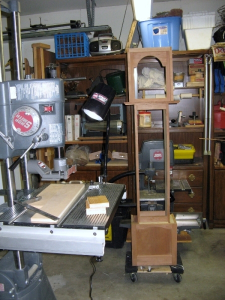

The Grandmother clock is my current project.
[ATTACH]15388[/ATTACH]

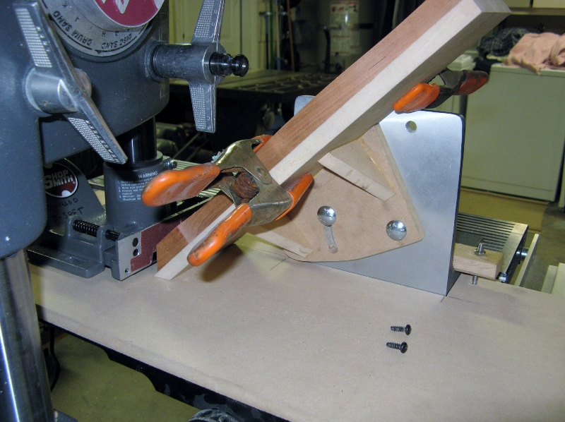

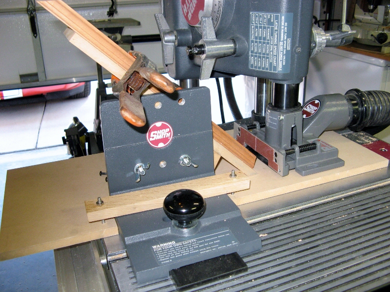

Thank you for your input. This is what I cobbled together using some ideas from both of you.
[ATTACH]15430[/ATTACH]
[ATTACH]15431[/ATTACH]

stumpbuster wrote:Reible & JPG40504
P.S. mbcabinetmaker: I have always thought some of my best work was done laying down.
Hey! You never told us you had a tenon master!
That looks like it will do the job as long as the 45 is correct.
Made joints yet?
P.S. Only 'improvement' I would suggest is a miter bar under the MDF base.
