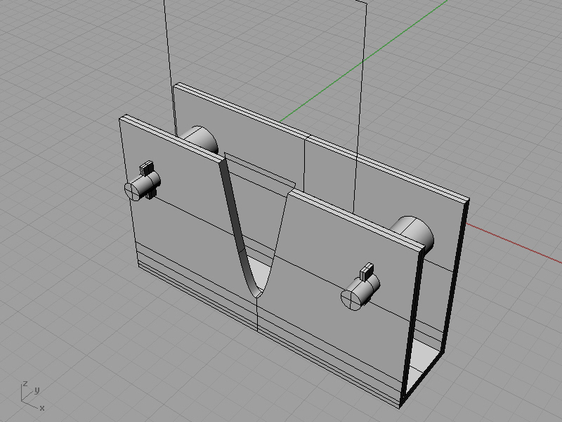

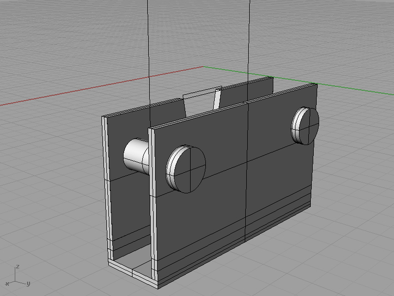

I just spent a half hour doing some preliminary designs, and here's what I have.[ATTACH]15444[/ATTACH]
[ATTACH]15445[/ATTACH]
I figure I can turn the side keepers and use pipe insulation to cushion them, and the use a tapered wooden wedge key to hold the box front against the larger diameter of the keeper shafts, and have an even larger head on the back side. I researched and found that 1/2 size cellos are 15" wide x about 5" deep (I'll verify that against my son's rental instrument later. If I plan ahead I can make the sizes of this stand adjustable to accommodate the 3/4 & full size later down the road.
- Stand perspective.jpg (164.68 KiB) Viewed 10186 times
- Stand rear perspective.jpg (168.74 KiB) Viewed 10246 times

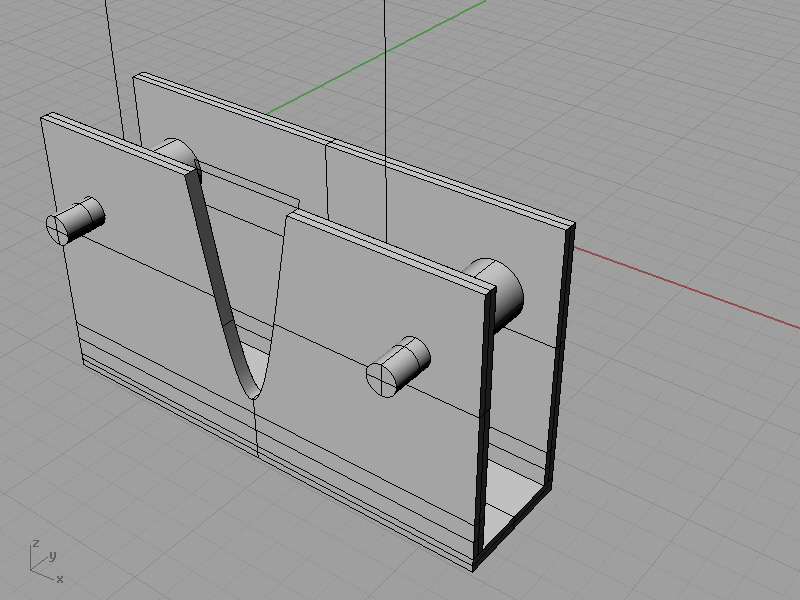

Keepers added.
Keepers added.[ATTACH]15446[/ATTACH]
- Stand perspective-2.jpg (178.43 KiB) Viewed 10178 times

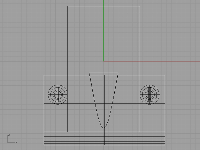

Front plan
Base peg would be extended into a hole in base plate.
[ATTACH]15447[/ATTACH]
- Stand front.jpg (107.53 KiB) Viewed 10193 times

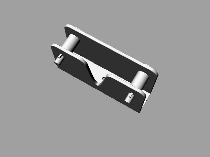

Prettied it up a little.
[ATTACH]15448[/ATTACH]
- Stand perspective-top.jpg (37.31 KiB) Viewed 10161 times
