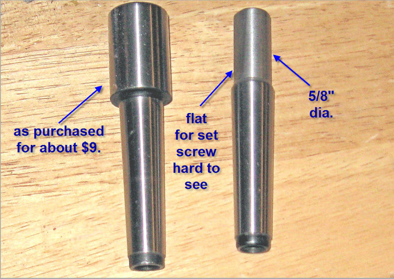

Coincidentally, a couple of days ago, I made one of these on my Southbend 10k metal lathe by turning down the cylinder portion to the 5/8" diameter. The MT2 stub is sold by Busy Bee Tools here.

$20 for the adapter is even better than the $35 I paid for a MT2 chuck. And the adapter would let you mount the sanding disk to advance workpieces into to square the end.reible wrote:Would it look like this?

Here is an alternative adapter for $8.95 from Beall -- http://www.bealltool.com/products/turning/tapers.php but it doesn't have the reverse taper.
Art in Western Pennsylvania
pennview wrote:Here is an alternative adapter for $8.95 from Beall -- http://www.bealltool.com/products/turning/tapers.php but it doesn't have the reverse taper.
That is easy to correct!
