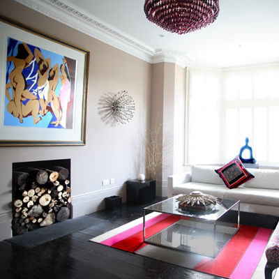

Let me clear though, I set out to do wide plank flooring. The planks were as wide as 10 inches. You could probably get 3 1/2 inch planks, unfinished cheaper. But, if you are as crazy as me, the job was enticing, cheap and I had the time. I was just looking for a pic and couldn't find one.
Here is a pic someone else did. Someday I'll do our upstairs master bedroom in it in this new house we are in.

Those yer inlaws in the pix on the wall?:D
