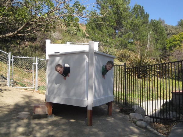

This project is a little bigger than my experience with pens or peppermills. Just finished building a pirate ship playhouse in the grandkids backyard. Still needs paint, but a friend artist has been drafted for special effects.

Anyway, any suggestions will be much appreciated. Pictures of the painted completed project will follow.
