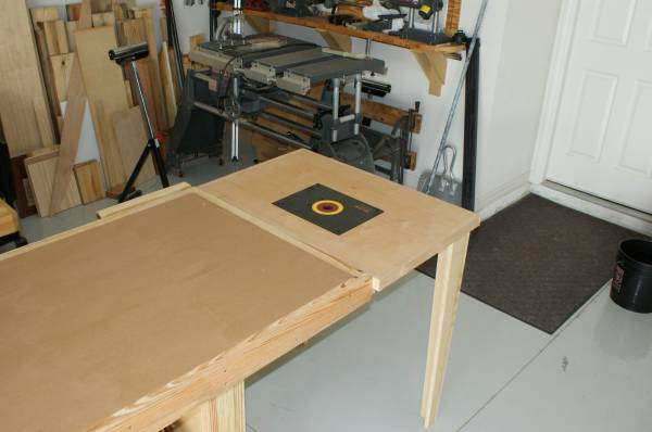

I have a router table that I made a couple of years ago and fastened it to the end of my main workbench. The workbench is from plans on the Woodsmith Shop TV show. The table can come off if necessary but I leave it on because it lengthens the bench.
[ATTACH]15894[/ATTACH]
Bill V
Bill V

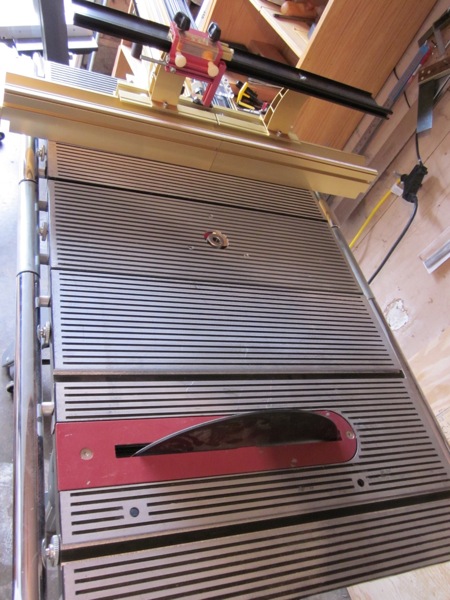

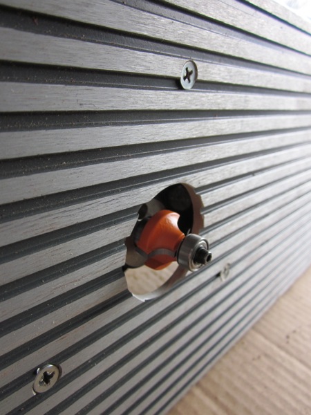

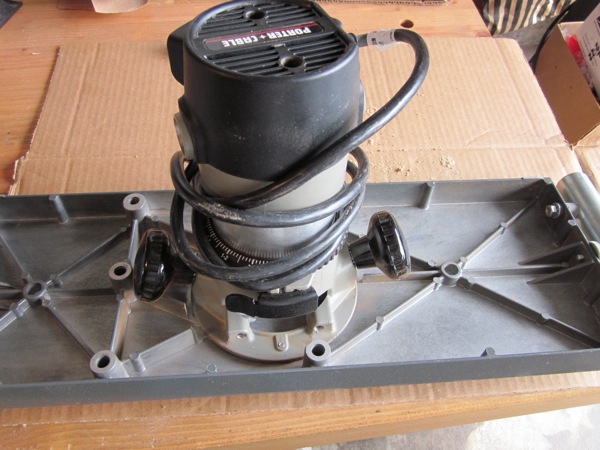

or you could always do this and really save space:D
[ATTACH]15895[/ATTACH]
[ATTACH]15896[/ATTACH]
[ATTACH]15897[/ATTACH]

You need to cut/grind out the bottom of one of your aux tables so the router will mount flush to the bottom of the table.
Then you need to drill the center hole to allow your router bits to come up thru the center of the table.
Finally you need to drill the holes needed for your specific router mounting plate to mount the router to the bottom of the table.
