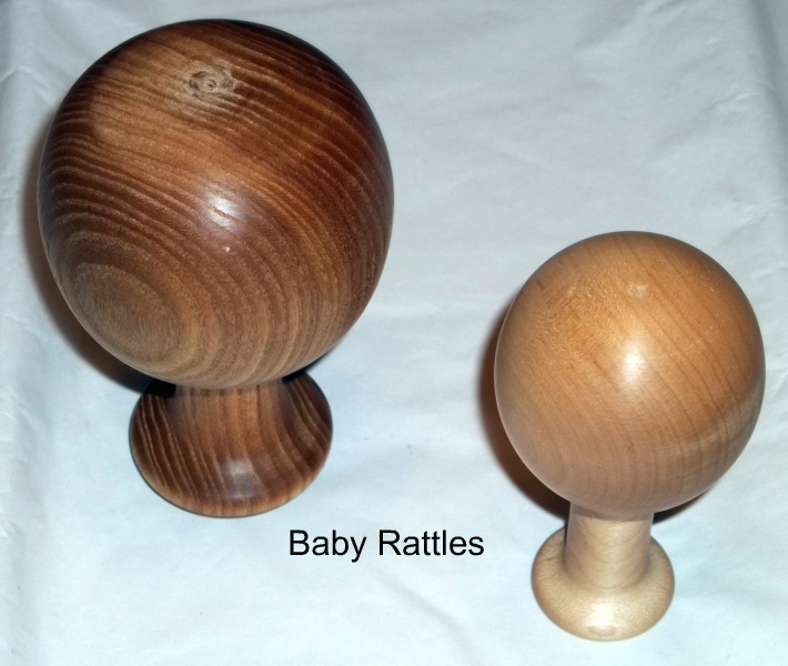

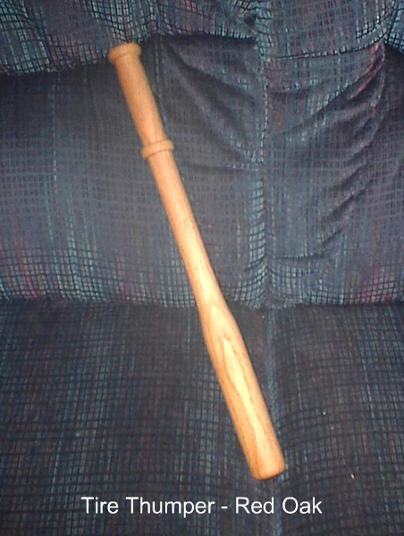

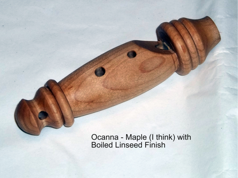

I've used both my 1955 500 (gilmer, single) and my 1989 510 with the "larger" motor (see other threads) and double bearing quill. I am not sure I can tell any major difference, but I do not consider myself an experienced turner.
Here's a couple of things I've turned lately:
[ATTACH]16167[/ATTACH]
[ATTACH]16168[/ATTACH]
